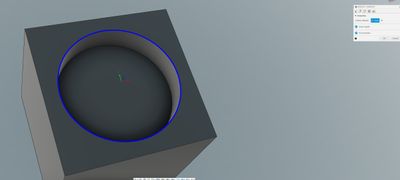

I am trying to use the engraving tool with a 90-degree vbit to engrave a design onto something. However, engraving traces out the inside line of my design rather than the outside line. Is there a way to change on which line the engraving mills?
I'm sure there's some obvious method, but I can't find it.
In my screenshot, you can see a circle engraving onto a block, but the engraving is on the circle's inner edge rather than the outer edge.

hyperbolicindustries
When selecting the line in the operation, you should see a red arrow. Click that to change what side the operation is cutting on.
And I think you are a little confused between using [Engrave] which varies its height based on the distance between the 2 driving lines/curves and something like [2D contour] or [Trace] which is just driven by the line/curve section.
In your example video the [Engrave] is being controlled by the outside circle (which is just curves because its broken and not a closed shape) and the outer edge of the letter, where your model only has the outside of a curve and not another curve to drive the [Engrave] operation
If you want to travel around the outer edge, that is only 1 curve to control that. That is a [2D Contour] or a [Trace] toolpath. That should NOT be an engrave toolpath. Engrave is only for if you have 2 control curves AND want the tool to lift up to maintain sharp corners. Engrave operates by seeing how deep the tool can fit while still touching 2 lines. 2 lines very close together will generate a very shallow toolpath, 2 widely spaced lines will generate a very deep toolpath. That is why the N looks kind of weird, because the width is not consistent sot that the tool cuts deepen in some parts and not others.
Its cutting to the inner edge (of the outer circle) because its is cutting between the drive 2 circles you have chosen.
In the example video he is not cutting to the outside of a continuous circle. He is cutting to the inside of a circle. The tool will try to fit inside that circle and avoid the other curves including the broken circle /arc segments and the letter outline itself. You are trying to do something different than what is in the video. Experiment with either [2D Contour] or [Trace].
What I mean about 2 curves for [Engrave] is that if you have 2 closely spaced lines/curves then the tool can only cut shallow while staying in between them. If you have 2 widely spaced lines/curves then the tool can cut much deeper. If it starts narrow then gets wider then the tool will start shallow and get deeper as the toolpath progresses. [Engrave] is a special use toolpath with more conditions needed that something simpler like [Trace] where you are just telling the tool, follow this line/curve at a constant depth.

djlunty
@jfrankovich
To get what you want with the engrave tool path you have to select the outside edge of the stock.  This provides the correct driving curves as discussed by @hyperbolicindustries .  The engrave tool path now knows what lines you want it to engrave between to  get the raised letter and circle that you want.  I have added  a pocket tool path with a 0.25  radial offset (calculated by this formula (tan 90/2)*0.25)   to clean up what the engrave tool path does not cut. This tool path does not get into all the corners as the bit is too big.  You could create additional pocket tool paths using REST machining with smaller bits to get into the corners.  Or you could create a fake square endmill with a very smalll diameter and use the engrave bit to get into the corners - still using REST machining.  This is the method used in the video that you referenced.  Model attached.
Your file had a 60 degree V-Bit but I changed it to a 90 degree V-Bit as that is what you said you were using .
Looks like your letter N runs into the circle - may have to make the circle bigger to get a cleaner look or maybe it works with the 60 degree v-bit.   You could run the pocket tool path first, do the V-Bit tool path then another pocket tool path with smaller bits.
Hope this helps.
Attached are the file and two screenshots - one shows a cross section of the machined stock.  The other shows the remnants that need to be cleaned up with a smaller bit.
