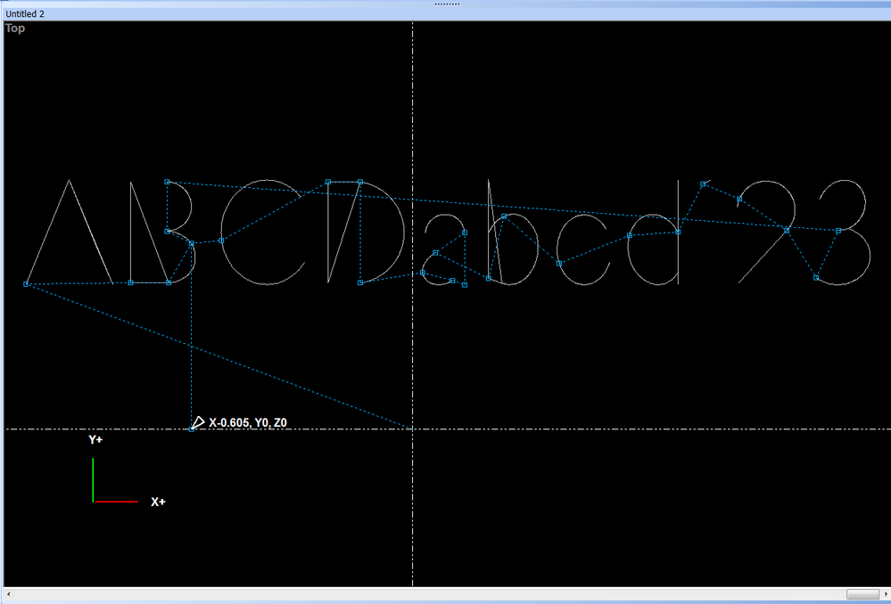

Justin from OLF reached out via email. I was mistaken, the font I was using was the universal, not the OC. Too many fonts for my brain. In any case he wanted a pic of the letters ABCDabcd123 for reference. Maybe this can get dialog open. I was amazed how quickly he responded to my query. 😉
Here's the text from his email:
"I’m surprised the OC format is in a way working for you, though with an added step. While searching to see what single line font features Fusion has I came across your recent post on the forum. I thought Fusion 360 had single line font support, but apparently not. I will definitely encourage you to make a ruckus so that AutoDesk might contact me for some help adding an ideal single line font feature.
In the meantime. Can you provide me with a screenshot of all the letters in the sample font: A.B,C,D,a,b,c,d,1,2,3. Showing the milling path will help too. Based on what I see on the forum there may be a workaround, but I’ll need to see the other letters to know for sure."
Now here is the rub. The universal font appears to post a whole bunch of segments rather than arcs, but if I understand the OC version correctly that would be corrected if the fonts were made native. I've attached my g-code for reference.
Here's the universal test font using trace.
This is the back plot, it may be easier to see what's going on rather than the trace path.
Message 16 of 30
Steinwerks
in reply to: randyT9V9C
Trace doesn't really do smoothing on the G17 plane, try 2D Contour with compensation turned off.
