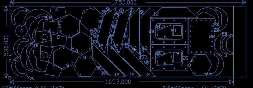

I have been using the Nesting and Fabrication extension to create laser-cutting patterns.  One of the items is a hexagonal hatch cover with 6 holes.    In Fusion 360 it looks like this:
When I export this sheet as DXF and open it in AutoCAD LT (or CorelCAD, for that matter) the hexagonal hatches only have 4 holes:
Very annoying!
