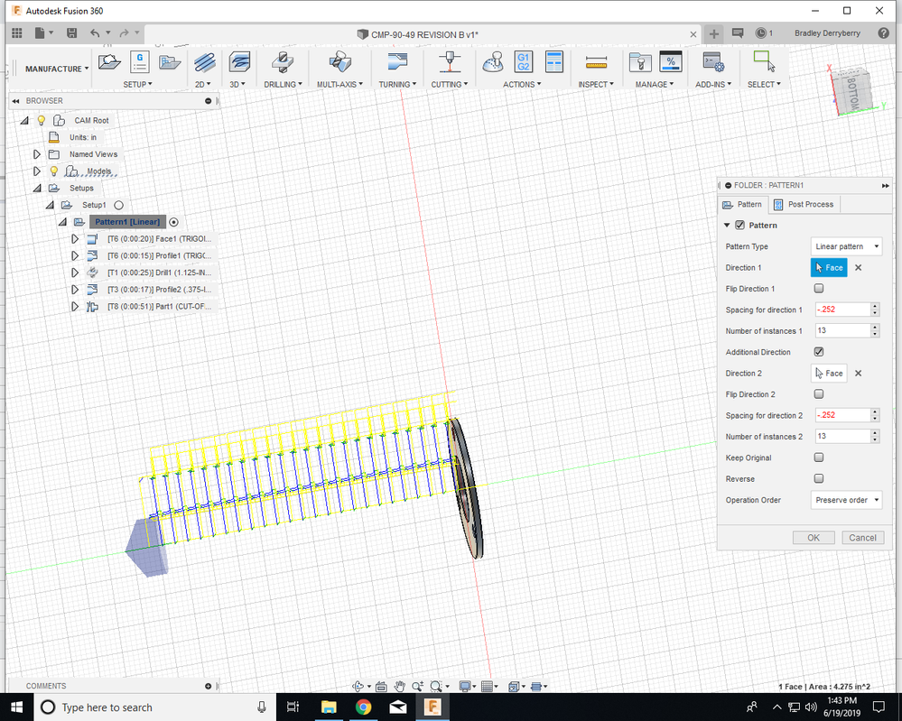

I trying to machine the same part multiple times out of one piece of stock. I only have one WCS and cannot incrementally change my work offset. I was hoping that I could generate toolpaths for one part and somehow copy these toolpaths multiple times so they would machine multiple parts out of one piece of stock. I’m not sure how to go about this other than manually generating  tool paths for each individual part which would be a long process
. Hope this makes sense

Try using a Linear Pattern in the Z direction. The New Pattern option is on the Setup section of the toolbar.

I think this will work but I just can’t get it to do what I want. At the moment, the simulation just keeps doing the same thing over and over at the same position in Z axis. When I output the program it just produces one part. I'm doing something wrong but not sure what
Message 4 of 10
Got it working and its exactly what I want.

When using liner pattern on the lathe this is the error I get. Naturally you cant really do cut-off parts in a positive Z axis direction. Fusion is reading the path as you can see, but will not allow me to implement it. I would like to do multiple parts, not imaginary parts. How might I make this work? lineardirectionnegativeerror.png

You can't input negative values. Input positive values and click "Reverse Direction"

That reversed the order of tools I believe. "Flip" however helped me achieve what is desirable, aside from the fact I will have to treat -.252 as zero.

Linear pattern will post main program for each new part with Z values shifted in absolute coordinate, could get pretty long and confusing.
If there is a memory limit in machine control you can do the following.
http://www.helmancnc.com/haas-cnc-lathe-g10-programmable-offset-setting-g-code/
Program one part and make it sub routine, use G10 at the top of part program to shift G54 by desired value each time program runs.
Run main program to repeat as many times as desired.
