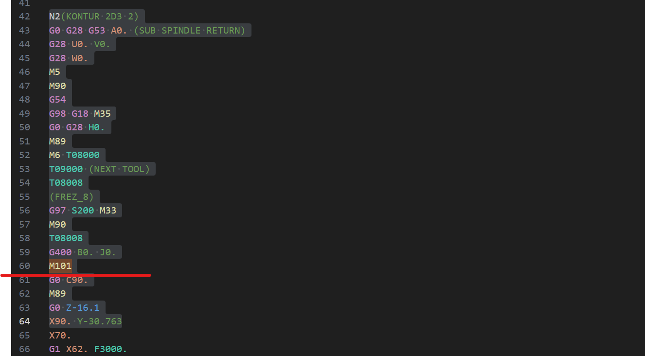

Hello! I have an issue with my postprocessor. I have eddited alot and one thing i can't make good.
I have a Doosan Puma MX2100 2007 year, with upper live tool milling spindle and lower turning turret. When i want to use milling at upper spindle i have to turn on Interference (M101) to turn off a brake on spindle. But this must be after tool changing and before turn on Spindle G97 Sxxx M33. But my post generate M101 in wrong place. Can you help me?
In attachments is my simple program and my post processor.

d_samsonZ7HUX
Zrzut ekranu 2024-04-30 130614.pngChanged post like u writed, and nothing changed in my program.
At the moment got program like this:

There are 2 modifications needed here:
1) You have to added the codes after line No 2347 :
    mInterferModal.reset();
    if (gotSecondarySpindle) {
      writeBlock(mInterferModal.format(getCode("INTERFERENCE_CHECK_OFF", getSpindle(PART))));
2) Remove line no. 1858 (attached screenshot below)

d_samsonZ7HUX
Perfect! It works! Thanks alot
