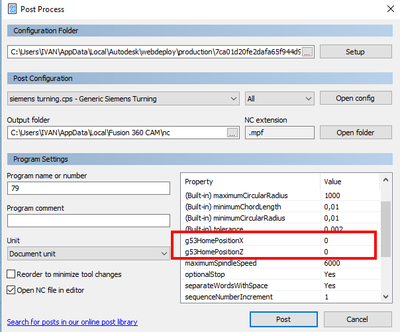

Wonder if you could help me with something else.My machine doesn't go to machine zero(MCS) after (g53) is called which is the top right hand corner of the bed after part cut off instead close to the spindle
Could there be something else in the post processor that is causing this.
Message 15 of 27
ivan.stanojevic
Could you show me the code that you get?
And please mark how do you want it to look like.
You might want to change those two parameters when postprocessing:
Those are related with the block of code G53 X0 Z0 which is the home position of the turret.

Hi Ivan here are two pix as well first position of turret thats where it thinks g53 is second pic is where I would like it to be and where MCS IS ZERO.
ATACHED G code
The screen shot of the g53 positions that you sent me in the post processor  should there be any value in those lines

When you put your turret in the desired position what coordinates are on the screen?
Ivan Stanojevic
Message 20 of 27
Carbidecnc
Z0 X0
