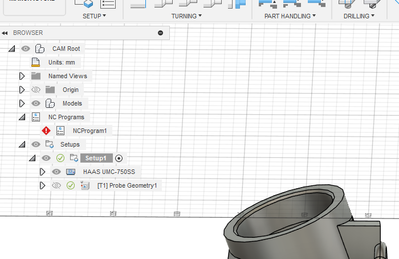

Hi everyone,
I'm getting this error in Fusion 360 while working in the CAM setup:
"Error: You can only select either a machine in the CAM setup or use the properties to define your kinematics. Error at line: 760"
I'm not sure what is causing it. I have a machine selected in the setup, but I don’t know if there's a conflict with the kinematics settings or the post-processor. Any ideas on how to fix this?

Hello, @nahum_garcia .
What post are you using? It looks like you probably trying to define machine twice - once on Fusion side and in post properties. And post says that you should not do this. If you define machine using post properties, don't attach machine to the setup, or use it in NC program.
