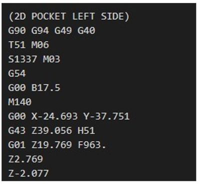

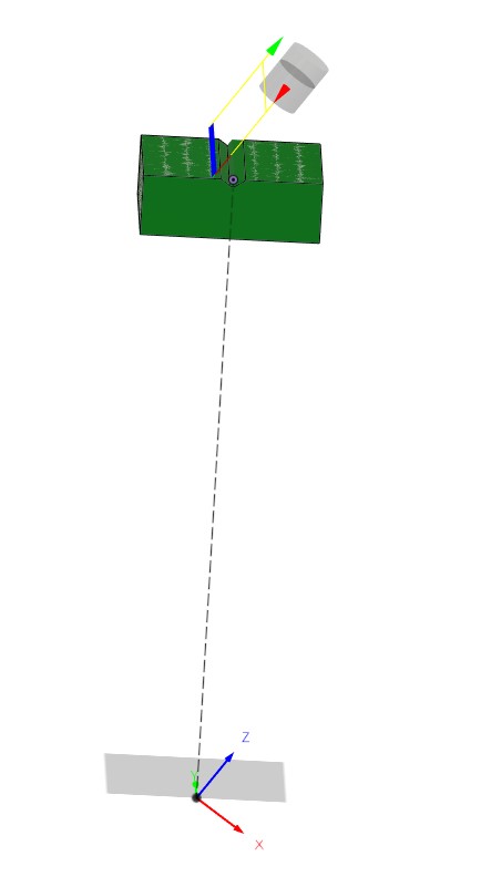

i am trying to mill a simple groove with B axis but after rotating the B axis xyz arent in correct  position.
the xyz are almost in the middle while the workpiece is cca 250mm to the right(See picture)
Have i choosen the tool rotation options wrong or should fusion output a dynamic offset or do i have to somehow compensate the rotation from the middle of the table or is something wrong with the post processor?
The machine i am using is a 4 axis horizontal with fanuc 31i
Thanks!

engineguy
@britovsekmatic128
With the Setup set to the center of the stock so it rotates around the B axis I get different coordinates, see images below for you to compare, first one is your original code and the second is mine using the center of the stock as the WCS rotation point. If you have the block of stock set with the back face aligned with the center of the B axis then you should set it the same in Fusion, where are you setting the WCS for the stock in your machine ?? See fourth image

britovsekmatic128
hi @engineguy
the offset is basically on top of the workpiece like on my model.
I was thinking to make a point from the current WCS move it ((Z-797.359)picture attached)
and select that for my tool orientation WCS.
Sorry i dont understand you about the post processor can you explain further?

engineguy
@m.britovsek
I am confused, in your image you show the Tool at an angle to the Z axis, is your Horizontal a simple 4 axis with th B axis rotating around the Y axis as in the image below ??
Is it Z in/out with Y up/down and X left/Right as in the image or does it for example have a tilting head ??
Are you just working from the Table or are you using a "Tombstone" ??

Message 13 of 14
britovsekmatic128
Thanks for the help.
I will try doing it tomorrow on the job since my F360 expired yesterday.
Message 14 of 14
britovsekmatic128
Many thanks @engineguy !
Moved the WCS in the middle of the rotaion/pallet and it works perfectly!
