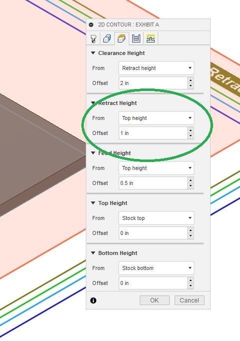

Here is an example. It doesn't seem to matter how I change the safe distance, feed height, lead parameters, or ramp clearance height.
Message 9 of 17
etfrench
Retract Height was set to Feed Height:
Changing it to be relative to the Top Height clears the warning message.
ETFrench
Message 10 of 17
Z-K-O
Thanks. So the only bug was that warning was largely unrelated to the issue that caused it.

etfrench
Starting from the bottom of the dialog, each height should be higher than the one below it.  It shouldn't matter where each is referenced from.

etfrench
All of the various height settings can create this warning.  The nice thing about it is Fusion 360 corrects the warning in the gcode (but not in the UI).  Do a Compare and Edit on the toolpaths in the attached file.  Exhibit A(2) just has the previous (Top height) change and B (2) has the Vertical Lead-In-Radius changed.  Both A(2) and B(2) don't show any warnings.
