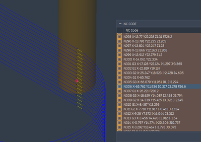

Which is right, tool path in browser, or in simulation?
jeffescott
Please see set up : lever tool path 2d contour 30 (2).
Note the yellow tool path lines that appear to go through the end of the lever.
Then compare that with the simulation.  the simulation does not show the yellow tool path lines carving up the body.
Also please not the NC program LEVER B&C 116F, this shows the proper tool path in simulation.
I conclude there is something wrong with the browser tool path....another glitch?  Really don't to waste some titanium....

kacper.suchomski
Hi
This is just a graphical issue.
Ctrl+G fixes this issue.

seth.madore
It's a glitch, for sure, but I don't think it elevates to "Major". What's happening is that we're calculating (for some reason) an extra "zero length" arc move:

@seth.madore
An "extra" zero length arc move sounds like a major problem to me. Using IJK on some controls will cause a complete 360° circle to be cut. I had a previously used CAM system do this on 1 level of a multi depth HEM routine and it caused major headaches. It might not SIM like a full circle, but it might real world into a full circle.
Message 9 of 14
viacheslav.shapilov
Fusion's postprocessor should ignore such kind of arcs. It has some additional processing of them.

GeorgeRoberts
If you use machine simulation, the paths you see there are the ones output and processed by the post processor. I loaded this your file into machine simulation and can see the large arcs aren't in the posted result
Like others said, I would recommend regenerating as that gets rid of this small arc entirely
