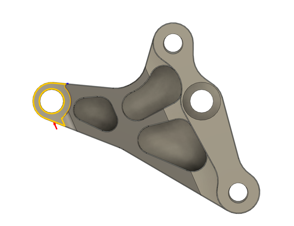

On occasion i'll use 2d contour and add multiple passes then use the Stock Contour check box and select the profile of the part to cut out the excess passes. Today on a fairly simple part I noticed when using this workflow the tool path is seemingly randomly extended and collides into my part.
As a test I tried to project the geometry into a sketch to drive it off that rather than the part itself yet I get the same results.
I'm thinking this is some sorta unintentional bug? I've included photos below

@Garrett_Wade
That would most likely be because you didn`t actually select a Stock Contour to limit the toolpath so it just defaults to include the whole part, see image below and attached file.

@Garrett_Wade
The error is because you have selected a 3D contour and tried using a 2D toolpath, Fusion has tried to follow your selection and failed miserably using the 2D Contour, hence the bad toolpath 🙂
If you only select the edges that are on the same plane then it will work correctly, ie don`t select the 3D edge of the Chamfer. See image below and attached file.

In this example i'm selecting the 3d path you mentioned to drive the tool path from the original post around the part and clean up this vertical section of stock highlighted below.
I have no issues with this, this works great.
My issue is when using stock contours on the entire part as shown above its driving the tool through the part into areas not selected:

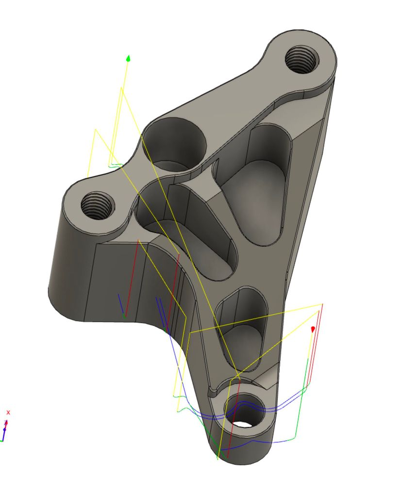

I've included photos below that hopefully help illustrate the issue better on this part.
Selection made to drive 2D contour and stock contour selection shown, notice the small area in blue selected:
Resulting tool path, please notice how the tool path added many new sections that wrap around and run into the part. These "extra" paths only exist when using "Stock Contours" and selecting the bottom of the part as the coutour.
If I remove stock contours entirely I get a good and usable tool path but its a bit longer than needed:
So what I am attempting to do is select "stock contours" and use the outline of the part to trim the parts of the tool path that are just air cutting to give me a tool path like this:
Notice out especially the outer most pass is heavily trimmed in the areas where it would NOT be over the part and just air cutting.
The root of my issue is that for some reason on THIS part unlike any part where i've used this technique in the past it seems that trying to use "stock contour" and selecting the outline of the part to trim the 2d tool path is not only trimming the toolpath but also ADDING a number of lines of code and cutting into areas of the model that were not selected.

seth.madore
I understand what @Garrett_Wade is trying to achieve and what's going wrong. 2D Contour with Stock Contours turned on should not be going through the side of the part like that.
This is being cause by this fillet:
 If we shorten up our selection just a tad:
Results are:
Forgive me if I've repeated something already stated, I did not read each post 100%, only enough to get the gist of what's going on

engineguy
@seth.madore
Hi Seth, yes, that is exactly what I did to make it work, I think this is possibly related to the old "fillet at the edges of open pocket" but the last section is a 3D line so it is a problem, and yes, I also agree that using the "Stock Contour" shouldn`t be affecting the toolpath but that is only something that the Developers can answer 🙂 🙂
In the Posters second model it does appear to be selected from a sketch (X/Y Plane) so the 3D Chamfer line is flattened out, maybe ???? 🙂 🙂

@seth.madore 100% agree its that last small bit of the chain in combo with stock contour that is causing the issues.
I've tried to recreate this "issue" in another part with nearly identical features (uploaded above in this thread) and it does not exhibit the same weird behavior.
I mentioned above the reason I was selecting that last chain (the section on the camfer) is because I believe it is necessary to not leave stock on that wall as shown below if I remove that chain:
My current issue is not how do I finish this part as there is many work arounds I can do like using different selections for stock contours, using a different body or manufacture model with no chamfer...etc.
But I wanted to make sure i'm not crazy here, and that is an acceptable way to use "stock contours" (to effectively trim a path)....and if this was an issue/bug that it was documented ASAP so it can be looked into.

I've opened up CAM-35904 to investigate this.
