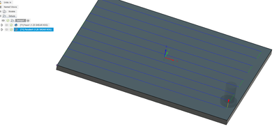

Or, if you want a "workaround" in Fusion that may do the job for you try the "Horizontal" toolpath, that you can set with the tool center boundary on the edge of the board so you should not get any over li its errors and fully machine the desired area, playing with the "Lead-in" settings should get you there, see image below and attached file for a very simplified example, may be of some help for different ideas  🙂 🙂 🙂
