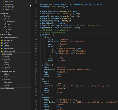

fixture,graphite, RMAX, cleanAir ... are all post properties, they are displayed in the nc program dialog to tweak the gcode generation.
So the error could have been i can't find the properties defintion in the post.
Or when using the elements from the post extension (cnc selector, machine selector, functions list...) it could be n issue identifying the active document.
(But i never encountered an error, if the nc code is active, it doesn't display or update anything, but doesn't error out)

Well, yes, I know and I have seen them listed in the outline. But when they are listed under "post properties" it allows me to change the value of the property on the fly, and see changes in G-code. It's totally possible to work without this, but it can be handy when one wants to test what effect have those properties on the generated G-Code.

@bernard5BABD When do you see that error message showing up? When you open a file? When you post process?
Regarding the properties, did you try to re-initialize the property list as shown below?

I don't see that error message anymore. It was showing up when I opened the cps file. And yes, I tried refreshing the list more than once.
