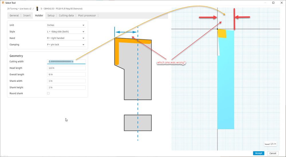

If shank width is one inch, then cutting width as pictured should be half the shank width plus offset amount of cutting edge.
Cutting edge dimension is not used in picture that way, it counts from back of the shank instead, apparent bug.

Hi @Anonymous ,
As @Anonymous has correctly pointed out, the diagram is incorrect for the Cutting Width parameter. The measurement represents the full width of the tool, as you have in red in your picture.
The development team is aware of the issue and we intend to fix it in the near future.
