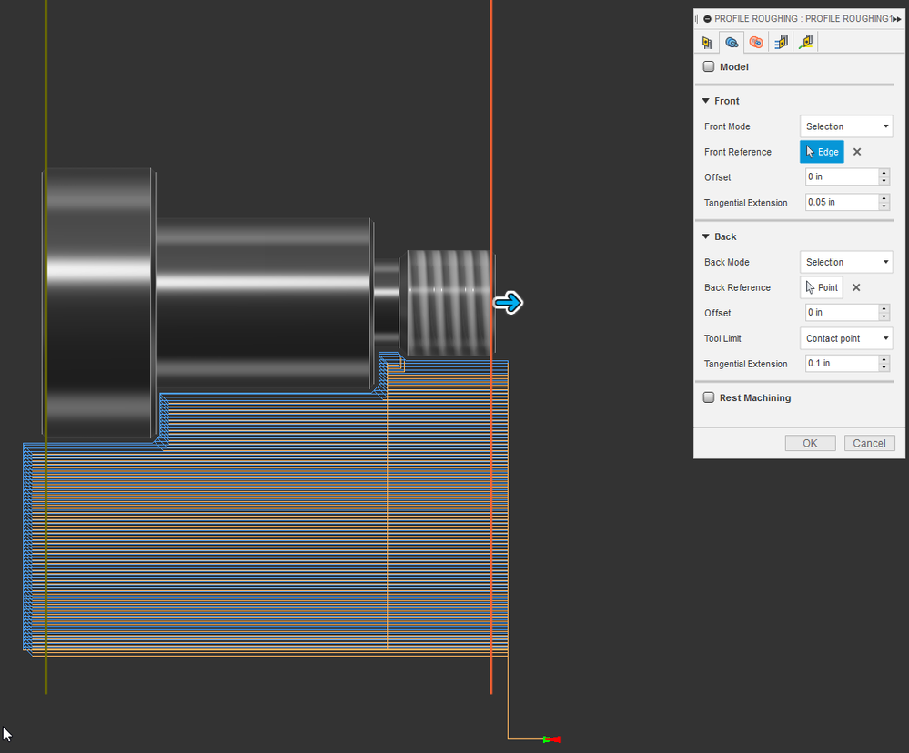

First time using the new divided rough/finish turning profiles, my part has a finish dia. of 1.188, stock is 1.25. Issue is the tooling is not made for a cut of that nature, if I tell it the stock is 1.5 my program does not change. Has anyone dealt with this issue on the new operations?

Here is the file. Stock is currently 3 inches, toolpath still doesn't recognize the stock. Thank you
Message 4 of 9
HughesTooling
Try these settings for front and back. Note I've selected the edges above the chamfers so the tangential extensions don't follow the chanfer. I've attached the file check the first 2 ops. You might want to add a facing op after the roughing op.

akash.kamoolkar
@HughesTooling Thanks Mark, yes that's a good workaround for now. Or you can also restrict the toolpath dipping into the back of the part by changing the Z limit and it will fix the issue. @Anonymous We are aware of this bug and it has already been fixed for an upcoming update.

HughesTooling
Here's another file. I noticed the finish cut didn't want to go past the back of the part if you enable rest machining.

Thank you, this will get me by until the patch is released. I appreciate the fast responses and knowledge of the software to keep us moving forward. have a great day!

@filipH9JM4
It's been fixed internally and will be released in an upcoming update. For now Mark's workaround can be used to tide over the issue.
