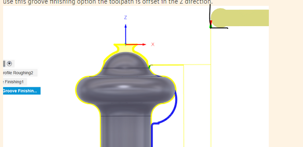

I’m newish to fusion. I have a question regarding the cam end of the software. On my finishing passes I’m using a 6mm round tip lathe tool, there is a 4mm radius at the bottom the part where the flange starts, that the tool will avoid by moving diagonally out past the corner radius.
The corner radius on the part is larger than the radius of the cutter. Also the tool shank is narrower than the cutter, as these were my initial thoughts why this would happen.
Can someone help me understand why this happens?
I have attached images to help explain better.
so many thanks in advance!
James

Two options:
1) Remove the holder from your current tool. Result:
Option #2: Define your tool as a Grooving tool and use the Groove Finishing toolpath:
Seth Madore

@77_JR you can allow multiple steps for groove finishing by setting it in "number of stepovers". As for your original issue with profile finishing I will make a ticket because the tool should be able to access that area.

Yeah i was having a play at trying to get it to work and discovered the groove finishing features multi-passes. unfortunately whenever i use this groove finishing option the toolpath is offset in the Z direction.
Thanks for raising the ticket!

no, the blue refers to the tangential tip of the tool, not the centerline of it. Simulate it step by step and it'll become obvious. It's always a mind bender when you first get into lathe programming to see your tool going "into" your part, but it's not because of the radii.
See how your entry/exit plane is at the "square" of your insert? (Pretend its a box and not a circle)
Please click "Accept Solution" if what I wrote solved your issue!

Ahhh that makes sense!! That will work perfectly then! Cheers mate!
