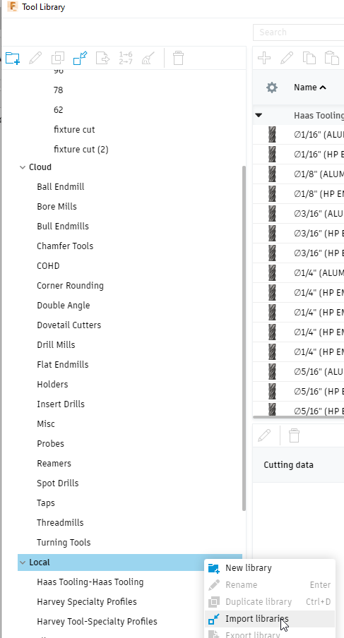

columbuss
So I have downloaded the tool starter pack. What next? It's riddle after riddle on this forum.
Message 14 of 21
seth.madore
Extract the tool library from the .zip format.
Open up the tool library in Fusion
Right Click on "Local" or "Cloud" on the left hand side
Click on "Import Libraries"
Seth Madore
