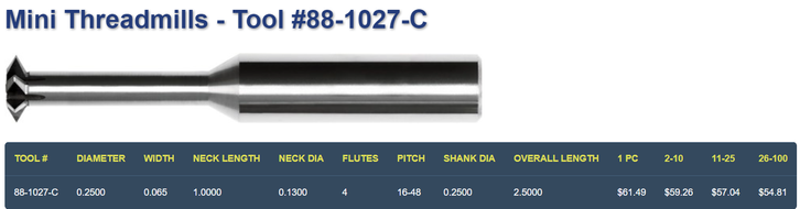

Whenever i threadmill internal or external threads, it appears that something isnt defined correctly to get the z height im targeting. for instance, heres what my sim shows vs what im actually cutting. I consistently plunge too shallow.
I keep thinking its something in the way i defined that threadmill in the tool library, but i cant figure out what it is.
The only hint i see anywhere that i dont have something correctly defined is the scaling the picture in my library shows. the total width of the flute is .065", but the picture scaling seems to represent the flute as only about ~.035".

Your z depth is the bottom of the tool, not the bottom of the thread. I also am unsure if your thread pitch info is correct when there is only a single tooth.

Thanks for the feedback, I understand the tool height and my toolpath height selection is what determines the cut depth. However, that is only the case when the axial end of the tool is a cutting face. I set my z height of this threadmill the same way ive set the z height for all of my other tools (which cut the appropriate z heights). the issue is that fusion seems to think the 60deg flute is offset from the bottom of the tool, less than it actually is (see the last picture in my first post as a refrence).
Think of it as if the threadmill flute was like an inch up the neck, fusion would know that geometry to accurately hit the z height your actually cutting.

In regards to the threading toolpath; it appears to be correct. Yes, the image that's reflected of your tool doesn't look right, but it's purely a cosmetic thing and not going to produce incorrect code. The g-code Z heights are based on the tip of the tool. So, if you're getting different results at the machine, I would look there first to confirm your WCS and your tool height is set correctly.

Can you by chance offer an explanation for how fusion knows where the cutting point of that flute is on that shank? Fusions defining tool geometry doesnt ask for Flute height (radial length of the flute), or neck diameter, so even given the angle of the cutter, the height of that flute doesnt seem to be able to be defined.
Message 9 of 10
leo.castellon
As Seth pointed out, "The g-code Z heights are based on the tip of the tool." It doesn't account for the actual cutting edge of the thread mill. This is to prevent for an example, the thread mill going too deep in a blind hole. If the thread mill went into the blind hole where the actual cutting tip is, then you would break the tool. In this particular case, you would add a thread relief so that the item would screw in all the way. In your case, just add some extra Z cutting depth so that the thread mill cuts a complete thread.
