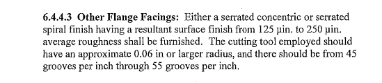

Well, that changes the whole ball game, you started with post about thread but your print calls for grooves of pitch density between 24 and 40 grooves per inch.
I think threading is not the answer here, what profile is the grove?, is there a sectional view shoving radius or "V" type of groove.
I think you just need to write a G-code to turn groves at desired pitch of about 32 / inch, can be G74 cycle, long hand or model the grooves and have Fusion take a crack at them if that is your preference.
Judging from surface finish requirements, I'd guess this is just bonding surface for rubber or plastic element, wish you posted that earlier.

See attached. This is really ALL the info I have and the customer isnt very helpful.
would you be able to help with the g code option? Unless fusion can do this?

I assume note pointing to part face supersedes one on lower left corner, if your customer is not helpful in defining what needs to be done, I don't know what they want either.
First thing is to determine what EXACTLY needs to be done than find a technique to get it done.
"Series of concentric grooves" or "spiral grooves" , have to know what customer wants to know what to do.
Message 15 of 27

Its a spiral on the face shown. Apparently its very common in some circles. See below. will this machine a spiral?

OK, look back at my post  (7 of 15), I gave you identical G code pattern  and asked you to adapt the concept to your need, your need before I ever saw print in upper post.
Yes, this and my posted code will cut spiral groove or "thread" on part face. The depth and pitch is determined by Z coordinates and feed rate / rev.
125 - 500 surface finish would suggest that only one .001 - .002 deep pass is enough to generate required texture, just an estimate.
Use threading insert for 40 tpi, having very small radius on tip, make one or two passes using F.025 .
You would then compare resulting finish to "Surface roughness Gage" for turned surfaces, or measure it by instrument called Profilometer (spelling ??).
Looking back at your print and circled note I see "SERRATED SPIRAL GROOVES" , so it is fair to say that threading pass will be compatible with requirement.
If in doubt about result, consult with customer, perhaps there is a sample part they can provide.

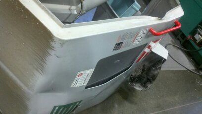

Well, you got all the right answers and yet you did not connect the dots, such as comparing my suggested G code to one you got from Facebook, I had to point it out when you asked if one you got from Facebook will cut thread on part face.
That really sounded an alarm here because it doesn't look like you overlooked it, in thread you started with limited information, it looked more like you had no clue as to what you are looking at.
So, my friend, for your safety, I sure hope you "speak" G-code and are not relying on Fusion to produce one that may or may not blow the door off of your lathe.
This one missed me by inches, someone cut the cycle time by wide margin, efficiency before safety, ..... ISO certified,
one of those....."leading manufacturers".
