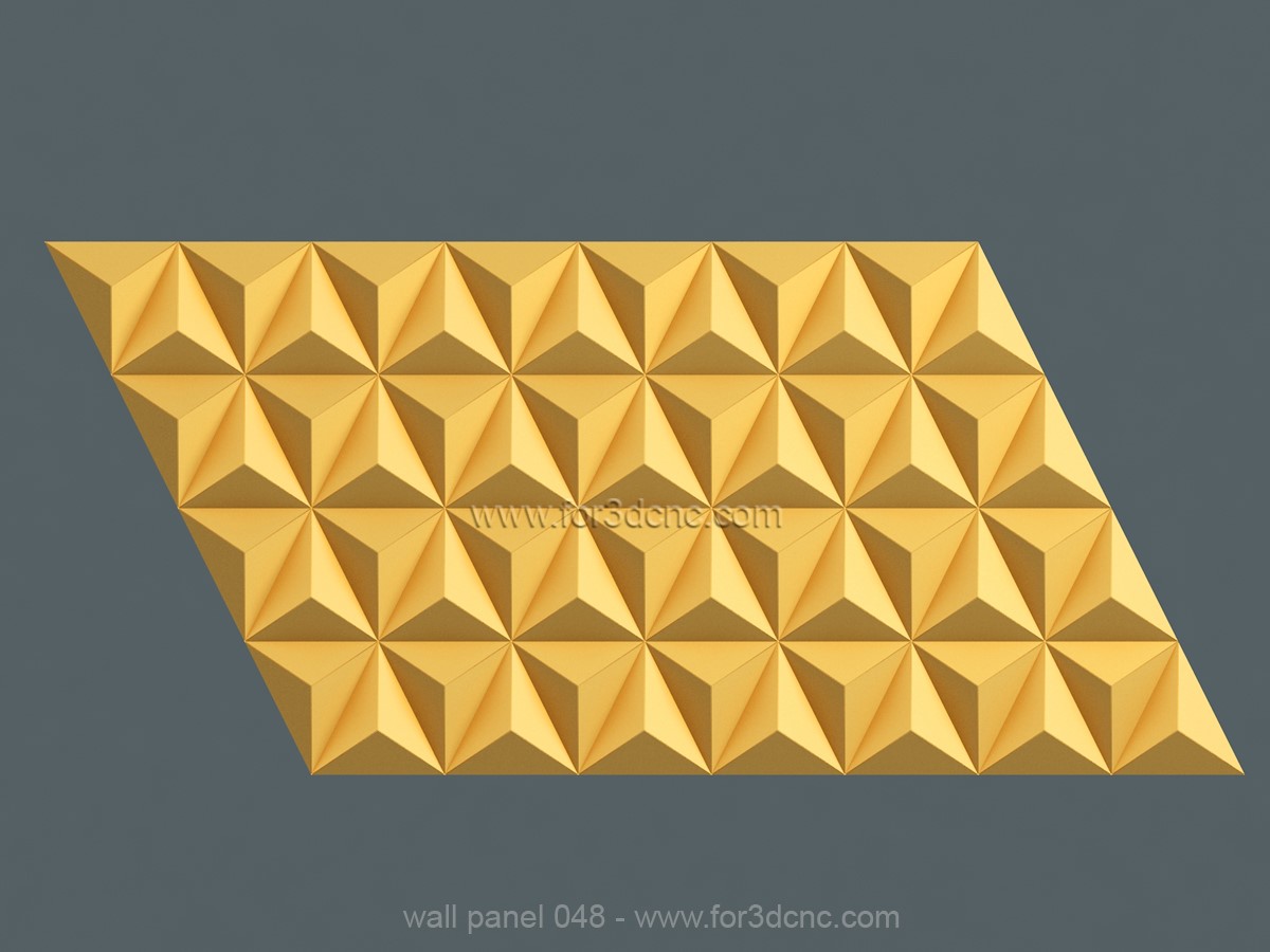

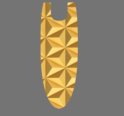

I've got to a point where I'm comfortable creating simple designs of flat parts in Fusion360 (plywood, flat-pack furniture). But I'm struggling a lot with giving the flat faces some geometric texture. I want something simple, done mostly with V-bit passes. But I'm having a real hard time modelling that.
Ideally, I should be able to have several of these "textures" at hand and use them at will on different parts. I attached a picture similar to what I'm looking for.
1) From what I understand, that would be done by simply adding lines and using the 2D engrave toolpath. But, in order to make it work on an irregular, curvy part, should I design the grid on a vector software and import it to Fusion? I'm having a hard time creating the grid-lines only within the shape I want. (trimming seems to be the wrong approach to limit the lines to be contained within the desired shape).
2) If I wanted to model the V grooves, to see for myself before actually making the part, is there a simple way to do so? The only "quick" way I found was to run the simulation on the Manufacture enviroment and watch how it would look.
I don't ask often as I prefer to do my research and trial and error, but I'm really stuck on this one. Some pointing in the right direction where and what to look for would highly appreciated.
Thank you!

For the texture, you want just sketch a line for each angle and pattern them in cam, not model cam.

You can do a sketch pattern if you want.
Example attached

I tried it and was able to achieve what I wanted. For these simple textures it's exactly what I was looking for, thank you very much.
One question though: how would you limit the toolpaths to the part? As you can see, the part isn't a rectangle, so if I make the lines to be contained by the thicker part, they'll extend outwards on the thinner part. Is there a way to do it from the Manufacture enviroment?
Or is that only achievable by making a custom sketch for the part, instead of using the pattern as you suggested?

This is one area where you have to be careful with the pattern you can use a sketch pattern for the toolpath and trim the lines to the edge of the part then use a 2D contour to do the toolpath as you can extend the toolpath enough so it leaves clean edges also in the passes tab you just set the compensation types to off for it to cut on the line.
The more sketch elements there are in fusion the higher the overhead on fusion is it can slow it down.
But there are ways around it like the areas where the lines are short you can use a sketch pattern there, then where they are the same length you can use a toolpath pattern.
