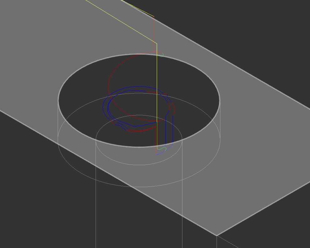

Deleting a contour with tabs moves the tabs to other paths.
Original toolpath with tabs on the outer contour:
Deleting that contour moves the tabs to the pocket contours:
Expected results: Warning that the deleted contour has tabs or just remove the tabs.
Actual results: Tabs are moved to contours with no connection to the deleted contour.

I just want to add that I experience this bug on a daily basis. It's pretty frustrating because the tabs that are moved to other paths are "phantom" so they have no node you can choose to deselect them, yet they still affect the toolpath.  The only solution is to clear all outlines and retab everything.  It's pretty bad.   I see this was logged in February, is there any kind of ETA for this bug fix?
