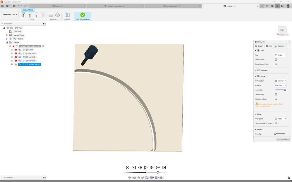

If I understand your way of defining the toolaxis you create a slicing sketch on the midplane between the two non-curved edges and define that as your z. I fail to see how this can be correct (though one might accept the deviation in less extreme cases). The stock simulation shows this.
What could be done, if multi-axis was added to trace, was to define your tool axis towards a point at the center of the arc.

I am only referring to your sample part.  See picture below, I think the deviation would work in your case.  Of course the smaller the radius and the larger the radius angle, the worse it gets.
