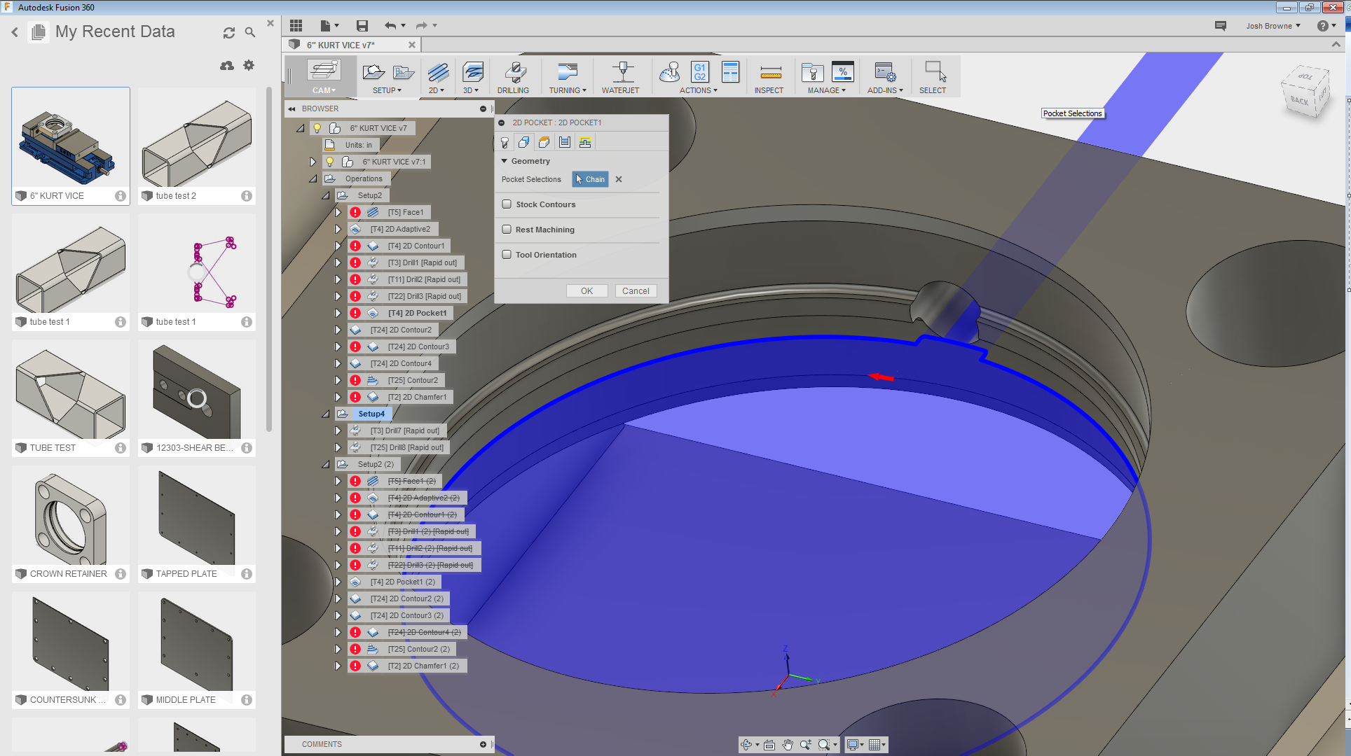

Sorry, these models are typically designed in Inventor, so I dont have the feature trees once I load it into Fusion.
Here is the 2d contour using cutter comp which alarmed because its trying to machine the hole

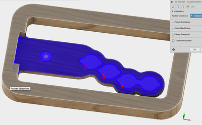

I was wondering if you’re selecting faces or edges. If you select the edge than the system won’t know there are holes in the part.

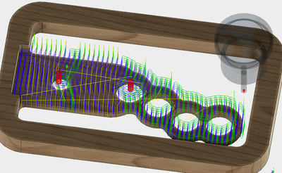

I like the idea of using patches and patch bodies to fill the gap, then sorting toolpath... I cant seem to achieve that at the moment.
Here is the part, I am contouring out the white space and then pocketing the narrow "island"..Ideally, I would ignore the circle button holes and mill out the pocket
But if I select the face, it includes the button holes...

So I tried to patch them and include them in the toolpath chain.
Burt it still really wants to clear out those holes, even though it isnt boring in at all, just seemly respecting the fact there is a circle there...

Have a look at the attached file. I did this two ways. One way I used a 2D pocket and changed the heights tab up to get rid of the extra helix moves (you may need to adjust the heights), and I also did this using a 3D Horizontal toolpath.
