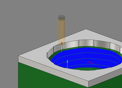

Hello Everyone,
I'm working on expanding one of our injection molds so its thick and have finally been I'm making chips this week. I have been taking off .010" each operation to get the desired expansion to .050" on the radius, .100" on the ID in the mold, without much issue until now. I'm going to take it do to .010" of the finished ID and decided to change the stepdown from .040" (default it was set to) to .005" to get a smoother finish and less polishing at the end. What I am getting now is that the tool path generated is mushrooming at the top, as in its going farther away from center than I want and its going to ruin the mold. Can someone help explain why its doing it and how to correct it? The walls have a 3 degree taper. My boss is worried it will make a radius at the top of the model and we cannot have that as it needs to mate to the other side of the mold.
It will be Contour 6 is the specific operation in the file

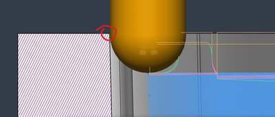

That's because it's being machined using the tip of a ball end mill.
It can be avoided by using an extended body.

This is a very annoying and unintuitive thing about avoid surfaces.(And Boundaries)
There is a tolerance that the toolpath works to and that means that it can work right up to the surface.
To prevent this from happening you can add a small radial clearance equal to the toolpath tolerance
On contour6(2) i show a different method using boundaries
You must turn on Contact point boundary and use a negative additional offset equal to the tolerance

mkilloran38SZU
when I do that, it starts milling what looks like half an inch lower than I want. Does that look right or is it a visual glitch?
Also thank you for helping
Message 9 of 18
a.laasW8M6T
That is correct
You have a .5" ball nose so it starts where the contact point of the tool meets the work piece.
If you want to start higher but not have the tool roll over then use an extended body or surface and add to the machine groups

mkilloran38SZU
Awesome, this is what I was hoping to do. I'm going to give it a try and see how it goes. Is there a way to do a continuous flow, without the retracts and rapid movement, that aren't at the beginning and end, on what looks like the first lap around? (the red, yellow and green lines in my screenshot) With your knowledge, I feel like its a setting right in front of me and I don't realize it

Sorry should have had the clearance in the axial instead of radial(I found a bug yesterday while I was messing around so got distracted)
If you use 0.001 clearance it cleans right up

Ahh
Looks like I had increased the tolerance in the passes tab slightly too
Another option is to right click on the toolpath and go into compare and edit and change the surface triangulation tolerance to tolerance x0.1(default is tolerancex0.5)
I would also turn on smoothing, Much nicer code.
No smoothing, Thousands of points:
Smoothing on
very few points with nice arc moves
