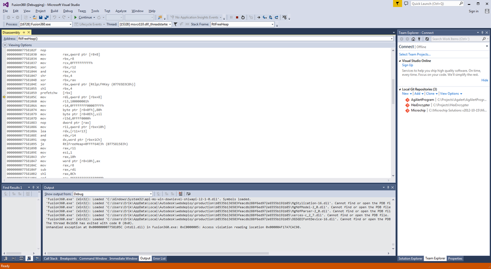

friesendrywall
Here we go again.  I wasn't doing anything.  I had just rotated the view and moved to a different program.
In the task manager, I show multiple AdCefWebBroswer.exe which seems a bit funny.3
So I hit debug and chose Visual Studio 2013, and it took about 10 minutes to load the symbols. per Fusion360dllload.txt

Tianq
@bensbenz, thanks for the information. I can reproduce the issue with the steps but not always. Still in investigation.
