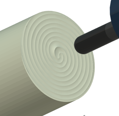

Looking at your last two posts, I think you are mixing apples and oranges in regards to only machining half the part.
In polar mode tool only works on positive side of X axis, whenever there is negative X coordinate, C axis is rotated instead of tool crossing center line.
This is equivalent of XY, 2D machining on vertical mill but Y axis is converted to angular coordinate of C axis.
Now in reference to your last post, you cannot do XCZ machining in polar mode, it's 2D function, tool is driven in position by Z axis, polar mode is started and XC machining is executed.
If you want to do XZC machining on face of bar stock, you can do one half, rotate C axis 180 degree and do the other half.
This eliminates assumed advantage of doing only half face on lathe, plus it opens possibility of miss match due to tool deflection at start and end of connecting edges at center line.
If you are looking to face off part using C axis and rotary tool you can create spiral drive curve and use Trace.
If you want to create texture for purpose of bonding rubber element for instance, you can use chamfer mill or ball end mill.
You can also use threading cycle to create texture on part face but that would have to be done by manual program, Fusion has some restriction in terms of what can be done with certain tools.
Attached is raw demonstration of what you can do in polar mode regarding "facing only half of the part", which is also not true because you are facing entire surface by means of rotating C axis instead of tool working on negative side of X axis.
Given same parameters, your cutting cycle time would be the same on both, mill and lathe.
2020-07-12 06_41_00-Autodesk Fusion 360.png2020-07-12 06_40_18-Autodesk Fusion 360.png

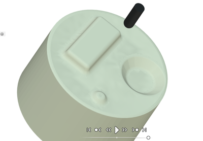

thank you for your reply, the bar face will not be a flat face it will be a detailed 3d feature face like a coin face for example and it needs to be done an a lathe but rather than moving the y axis and x axis to spiral as per your sample which is effectively milling the complete surface what i would like to do is use the c axis to rotate the material precisely in combination with the x axis and the z axis, note the z will simply be going in and out as the x travels from the outside into the centre to machine the feature.
in this way there should be less machining than on a mill  as the x travel is only from the o/d to the centre as opposed to the hole circular surface.
is this possible?
i hope this makes sense....
Message 7 of 16
In regards to only doing half the face on lathe vs full face on mill,.............. which half do you want to do on sample part below, half with rectangle, half with circles or half of each ?🙄
My point is, there is no such thing as only doing half the face on lathe to save cycle time, you are cutting full face on mill and lathe, only difference is in how mill-turn handles it compared to vertical or horizontal mill.
3D tool paths, XCZ motions managed by polar coordinate, just rotating C axis to keep tool on positive side of X axis.

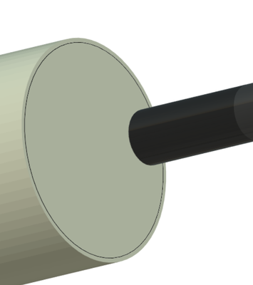

In 2D tool paths you have choice of doing XC or ZC, tool is positioned in place, depth in Z or X axis and other two axis are driven to produce contour or pocket, in sample below tool is first positioned in X axis then Z and C axis are driven along selected contour.
In sample shown in my last post, Z axis is first positioned to depth then X and C axis are driven along selected sketch.
