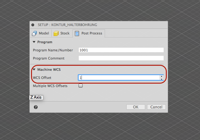

It seems i can't open a Post right into the "Post Process" dialog on mac.
I use the Mach3Mill Post for my CAM's and want that is map the WCS 1,2,3,4,5... to G54/55/56/57... 🙂

I just tested the mach post and it seems to work.

Ha, it works!!
The problem was that the WCS-Offset 0 was corrected to WCS 1 which is G54.
If i enter 1 into the WCS-Offset, it is 1 and is not corrected and write in G54.
I must enter 2 to get G55 and so on. Smiley Very Happy
