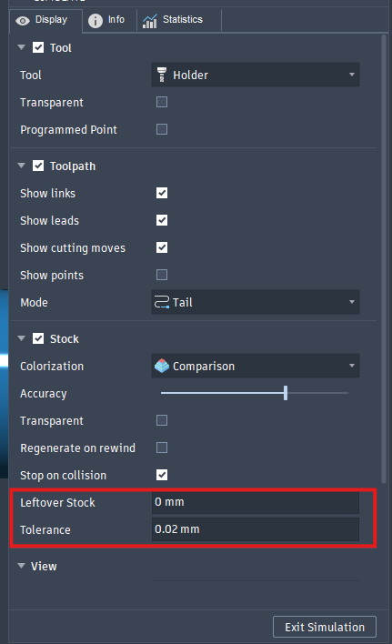

Hello, I have a model body for the stock and a model body for the part. In simulation, it is showing the part as RED under Comparison. It should be GREEN. Why? It keeps happening. Have never had this happen before. Thank you! Is this a bug or are my settings wrong from an update not maintaining normal settings?

a.laasW8M6T
Hi
You probably accidentally changed this setting:
its easy to do if you scroll down the preferences with your mouse and the pointer lands on a drop down it will also scroll through those options which is a bit silly

Hello, Thank you, that setting was on Red below. I never change my settings but they got messed up after the last update.
ONE issue though -- it is showing blue instead of green where the stock and part are the same size. I feel that in the past it was GREEN. ???

a.laasW8M6T
Check the values here in simulation, if the tolerance is too large it may not show up as green or if you have a value in leftover stock

elizabethX83R9
It was leftover stock. I really don’t like when all the settings change after an update. Especially when there are so many updates. Thank you for your help!
