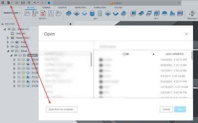

Give this file a look. I've added a few toolpaths; 3D Contour to rough the inset, 2D Contour to machine the chamfers (you're chamfer tool was defined as 10 degrees, you've modeled 45's).
To open the file: Click on "File" > Open > Open from me computer > Select file
