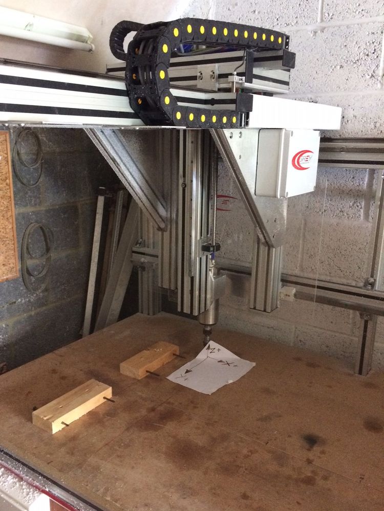

for some reason I always struggle with trying to get the arrows to go in the correct direction to what I want! my machine has the zero at the far right hand corner in this picture so I want to set the x down the long edge of the part the y coming across the part and z going up from the bottom right hand corner of the stock box but for the life of me cant get my head around how to and cant figure the lodgic but know it should be simple!

LibertyMachine
In your attached image, you have the orientation correct, it's just at the wrong side of the part, is that right?

charlieuk
the x and z are correct but I want y going the opposite direction ideally I think

LibertyMachine
That is a configuration that is impossible, like asking for a square circle. The arrows indicate positive direction of travel. Here's an example:
Extend your left hand and make a fist. Pop your thumb up and point it at the ceiling. This is the Z axis.
Point your index finger at the screen in front of you, this is the Y axis
Point your middle finger and have it run parallel to your desk/keyboard etc. This is the X axis.
Each one of these would be positive directions of travel as far as the Cartesian Coordinate System is concerned, and that is what the whole basis of CNC machines are designed around. This is the meaning of the arrows in Fusion.
Does that help any?
The best we could do is get it over to the other side, which is simply a matter of picking that point

charlieuk
cheers many thanks I think then when I built my machine because of its design being a cantilever I got it a bit backwards, I only have used it up until now on a with a surfboard program that doesn't seam to mind what direction things are.
it could be a bit of a headache to change it all around as I'm going to have to move the home position and figure how to change it in mach3 which I have forgotten how I set up.
I'm just designing another machine which I will try and get it right on!
