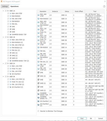

Up to now the "Reorder to minimize tool changes" function has worked flawlessly for multiple setups with different WCS.  However today it's not working as expected.  Not sure what has changed but even older CAM files that were posted earlier this week using the same post processor won't reorder operations now. I believe I must be overlooking something simple unless something in Fusion has changed recently?
I am running a job with 16 work offsets, 4 operations, 4 parts and the program was running great until I made a little change to the speeds and feeds of one tool now all of a sudden the program is all out of order.

fr33l0ad3r
Use NC program. Checkbox in a second tab.

engineguy
@admin
Looking at your image it appears to be a single Setup, the re-organize doesn`t re-organize tools within a single Setup, to organize within a single setup then you should "drag and drop" your operations to the order you want within that setup in your "Browser" in Manufacture.
If you have multiple Setups then the re-organize will do all operations with say the 8mm tool in all Setups before changing tools.
It does also appear to be very smart and will not use a tool for example to do a finish contour round a pocket if the pocket has not already been machined, this is how it seems to work to me, maybe not perfect but pretty good in my humble opinion  🙂 🙂 🙂

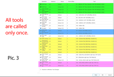

I removed all chamfers and renamed wcs so this can not be an argument anymore. (new file is attached)
The problem didnt disappear. I made couple of screenshots, maybe  with them it will be more clear what I mean.
Pic.1 is an operation list without reordering, lets use it for reference.

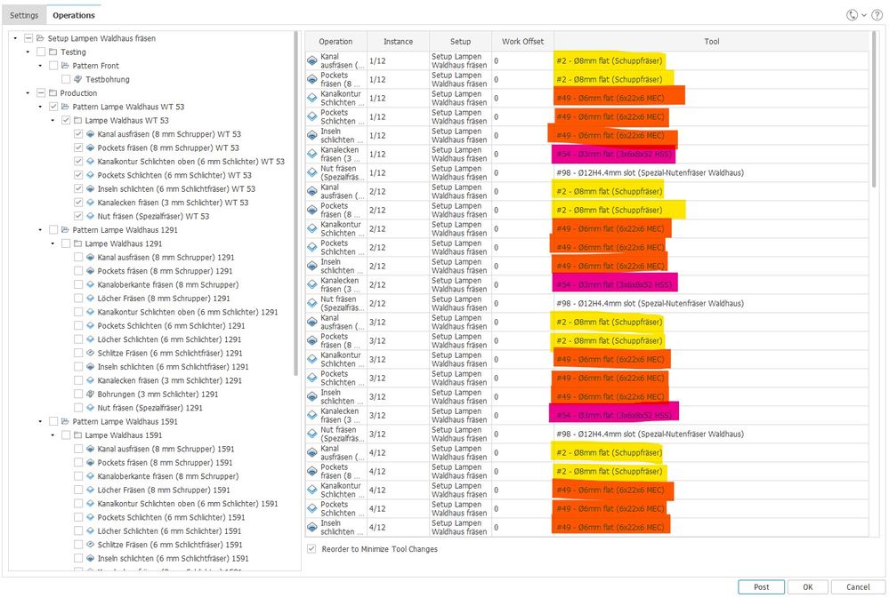

If you look at Pic.2 you should see that after I turned reordering feature on  Fusion grouped operations with tool #1 and #4, that is right!!! But it didnt group operations with tool #19 and also with tool #10, why?
I also attach Pic.3 where you can see how operations can be grouped to call each tool only once and reduce the cycle time. It wasnt generated by Fusion 360 , I made it in Paint.
Less than one year ago Fusion generated operation list like on a Pic. 3, now it generates like on a Pic. 2. You think this is ok?
