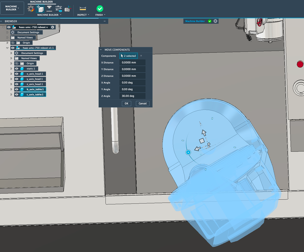

I have tweaked the machine builder model so that the B axis bakes in the 30° angle.  This makes attaching the part to the rotary table work out; Fusion assumes that the part WCS and the machine model WCS have the same orientation.

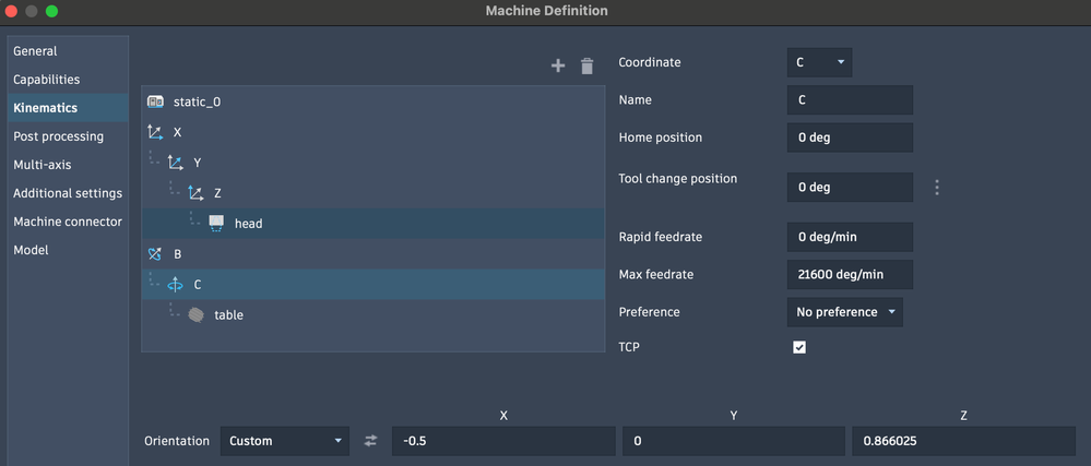

The machine kinematics set the B home to -30° and rotate the C axis.  The magic numbers are the result of the sine and cosine formulas above.

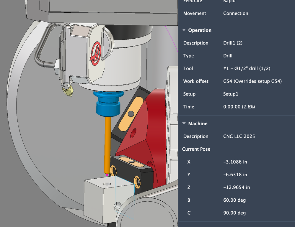

In the machine simulation of drilling one side of the cube, the B value is 60°.  That, plus the 30° in the pyramid, rolls the face 90° to be normal to the spindle.

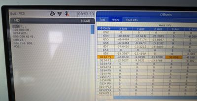

I think that N145 G254 is going to give you trouble if there's a non-zero B offset in the machine control.  Quoting from https://www.haascnc.com/service/codes-settings.type=gcode.machine=mill.value=G254.html , there's a call-out "The B-Axis value of the work offset you use with G254 MUST be zero."  Disable the use of DWO in the post property so it uses only G234 (TCPC)
I set the following up as a quick test to revalidate my recollections
G154 P1;
G90 G0 B0; (ENSURE MACHINE AT B30)
G234 H25; (TCPC ON, T25 LENGTH COMP)
G90 G0 X0 Y0;
G0 Z6.;
G0 C90. B60; (MAKES A COORDINATED MOVE)
M30;
The machine arrives at the following condition:

You'll only need a single "B30" machine model defined. The C axis position doesn't really matter so much; this would work with two- or a four-sided base just as easily.  Each machine WCS will have an arbitrary C offset value that makes your vise jaws parallel to either the X or Y axis, depending on how you've chosen to set the vise on the pyramid.
If you start with the UMC-750 model from the library, use the "Move Component" command to rotate the trunnion to bake in the 30° angle.  This will make your CAM setup attach to the table geometry in the correct orientation, since the setup Z needs to align with the machine model Z.
Update the machine model to subtract the 30° that's baked into the CAM model in the home position and axis limits.  Also update the C axis to set its orientation vector as shown in the previous screenshot.
You could choose to add the pyramid to the machine model's "Table" geometry, or you can keep the pyramid as a setup fixture.  My personal preference is to keep anything that gets bolted to the machine in the CAM setup.  The argument for adding the pyramid to the machine model is to have an attachment surface in the machine model that's normal to the Z-axis, since that's the typical case.
Verify using the "Preview Machine Movement" tool
