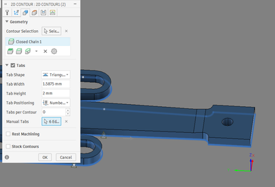

See screen shot
I changed the shape of the contour tool path.  The tool path updated nicely, the tabs seem to be all shown in the correct places, but the drop down indicates that there are missing selections.
How do I select the existing tabs (the ones shown on the tool path), to avoid reentering them

programming2C78B
Why dont you just click yes on this?
If you select the highlighted box then CTRL+Click the white dots you will remove them as selections

jeffescott
I wan to keep the selection of tabs, shown on the drawing, I do not want to have to reenter the tabs, they look fine
jeffescott
On the screen shot the tabs on the part are perfect,  yet on the drop down it says some are missing....not sure why, just wan what I already have.
This has been an on going issue for me.
programming2C78B
Yeah so did you do the first part of what I wrote?
Please click "Accept Solution" if what I wrote solved your issue!
jeffescott
No I did not I thought that would clear all of my selections but it only clears the entry box...perfect
Thank you for staying with me in my confusion.
programming2C78B
yes, for clarification all it does is remove anything that is now "missing"
I often will click NO first if its a contour selection so I can see the red error outline and see what it WAS doing before I moved a toolpath or edited my model.
