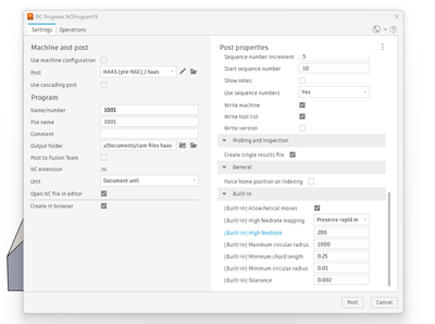

Hey guys why is fusion posting this crazy fast feed rate? How do I fix it. 2012 Haas vf1. Haas pre ngc post processor. Iseet the built in high feed rate at 200.

a.laasW8M6T
Might have something to do with the document units, are they metric?
there might be a conversion issue in the post

I'll have to check in the morning if it's set to metric. The other 5 tools ran great.  The machine alarmed out when it got to tool 6. Usually everything runs fine. The difference is that instead of using my personal space I decided to switch over and use the team space or whatever it's called. So my usual post processor wasn't there and I had to import again.

nocturnalwelding
I just posted for another program and it didn't output that crazy speed. mmmmm
Message 7 of 12
nocturnalwelding
I just looked and the model was send in mm but I already had changed it to freedom units.

nocturnalwelding_0-1707844681482.png ok I found it in the plunge feed rate. Idk how it got there but I overlooked it. Just glad i got it!!

In your plunge feed rate you have specified 25in/rev😮
