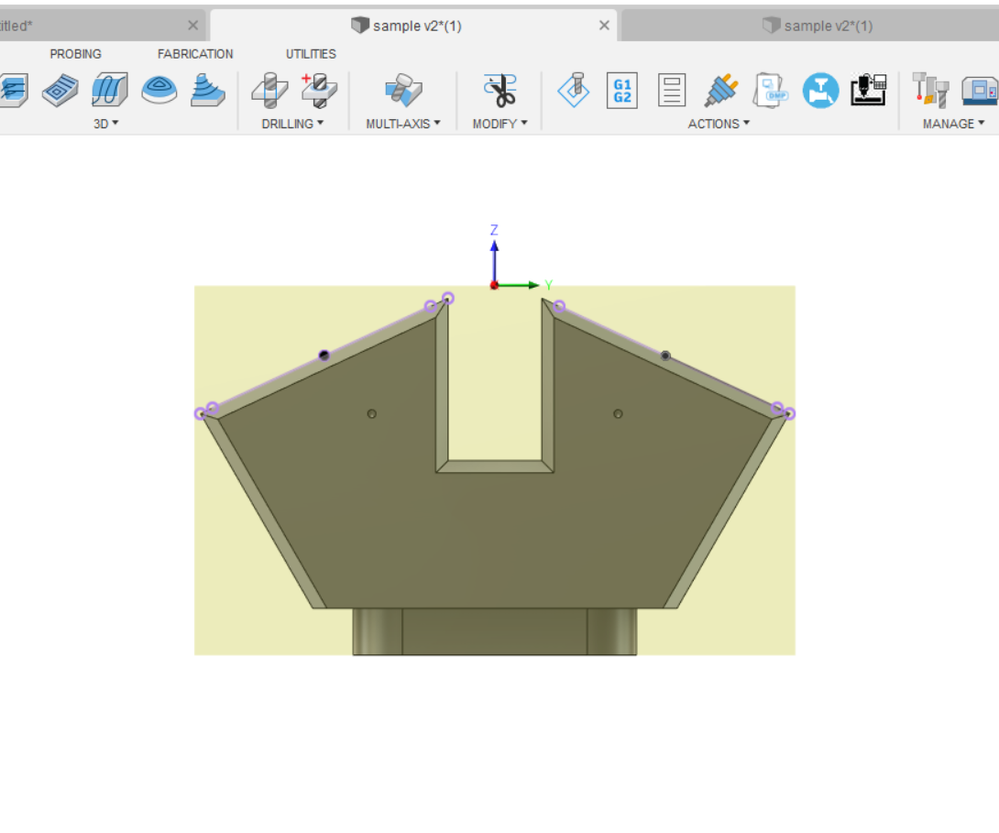

I have an issue with one of my 5 axis post processors. I've attached a stripped down setup and a copy of my post processor.
The first drilled hole posts out correctly at A0. B65. The second hole is trying to post out at A180. B-65, which should be A180. B65.
I have a similar post for a B & C axis machine which works fine, but the job wont fit on that machine. I've got a feeling the issue lies within table:true/false in onOpen, but i cant seem to hit the magic combination.

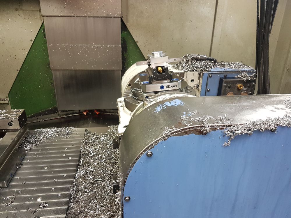

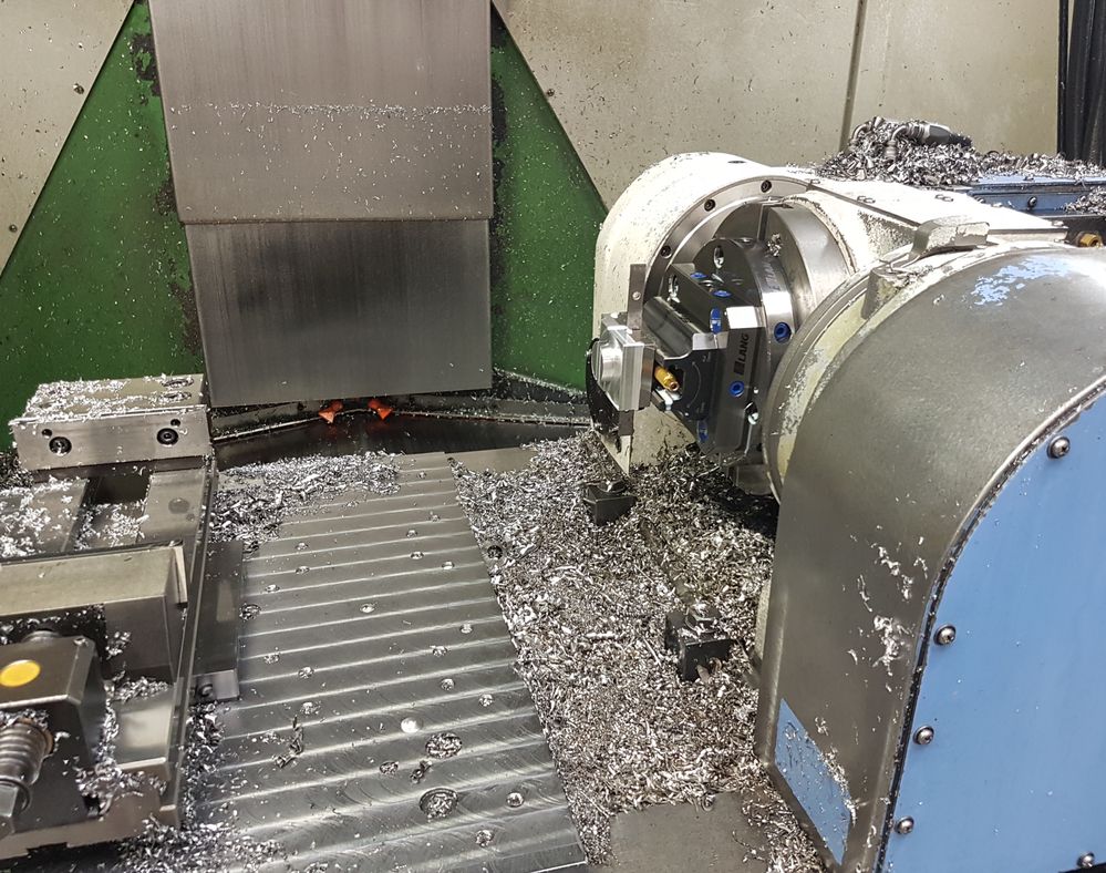

Machine is a vertical, with an aftermarket rotary table.

Rotary axis is located on the right hand side of the bed, B0 is perpendicular to the Z axis, facing towards X-. B90 faces towards Z+.

This machine is setup so B0 runs with the X axis, think like a 4th axis rotary table on a vertical machine. It's not something I can get around on this machine.

also i am not sure about the machine kinematics do you have any pics of the machine ?

B0 positionB0 positionB90 positionB90 position
