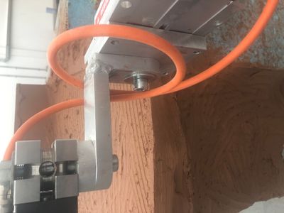

engineguy
@stephen.brindle
Stephen, what is really needed is the actual configuration of your machine, if you have a Trunnion type indexer (A and C axes configuration) that is on the bed of your machine then what @DarthBane55  is trying to do for you will work, create a toolpath turn the indexer to the required angle, touch off your tool and cut the toolpath. As has been suggested for that scenario all you need is the basic 3 axis Mach3 Post Processor.
However if one of your Axes is on the Head (Swivel head A and B Axes configuration) then that is going to be a bit more involved so please upload a photo of your machine, that will make it much easier for @DarthBane55  to do an example program for you. If it is a swivelling head that rotates then it a whole different way of working.
So please let the Community know what is the configuration of your machine, to upload a photo click on the Camera Icon at the top of your Post and that will open a path to your computer that says "Choose Files", just navigate to where you have saved the photo and select the one you want to upload and click "Open" and the image file "preferably a .jpg format" will be uploaded and inserted into your Post.

stephen.brindle
 tut 90 on both photos thanks
Message 14 of 34
engineguy
OK, now we see the photo, went up while I was typing, thanks very much, something to work with for you @DarthBane55  now 🙂 🙂

stephen.brindle
 hi sorry these are the only photos I have the machine is s post and arm retrofit single and motors
