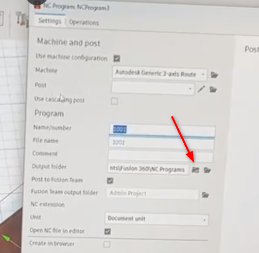

I select my machine and post grbl,  name the file and click on post.   the post process dialog box just closes without creating a .nc file.   It does however create an ncprogram on the browser.   there no error messages at all.   I've tried everything i can think of.   anyone have any idea what i should do?     Thanks

seth.madore
Are you running multiple monitors?
What happens when you click on this button here:
Seth Madore
Message 15 of 17
greenkarson
Single monitor.   That just opens up output Folder.  Which is empty.     I've removed and reinstalled Fusion, no difference.

HughesTooling
I notice you have post to Fusion team checked, not sure if you can save to a usb and team at the same time.
Try unchecking this option.

FrodoLoggins
I just posted with the below settings (Output folder = flash drive + "Post to Fusion team" selected):
Not only was my file posted to my flash drive, file opened in my code editor, and link to the file in my hub opened in my browser, but I actually have 2 post files (1 duplicate) in my specified Fusion team output folder and the blue loading circle that wouldn't go away until I clicked the refresh button:
So at least in my case I can post to both places at the same time.
