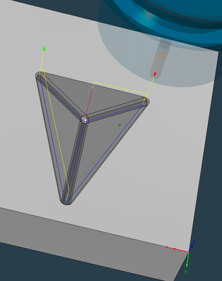

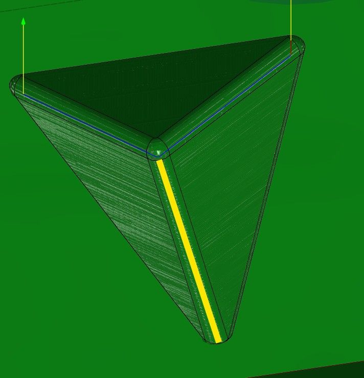

I am not able to get the pencil tool path to cover all areas on this work piece. Currently it's going down the corner path on the back wall ( which is what I want ), but I would also like it to follow the bottom curved edge face ( Highlighted in Yellow )
Here is a link to the file:
https://a360.co/4n24BiW
Thank You,
Kent

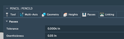

Add a touch of overthickness:
Use avoidance surface groups if you don't want to process the upper edges.

Thank You very much for your help on this.... that did the trick.
Thanks again...
