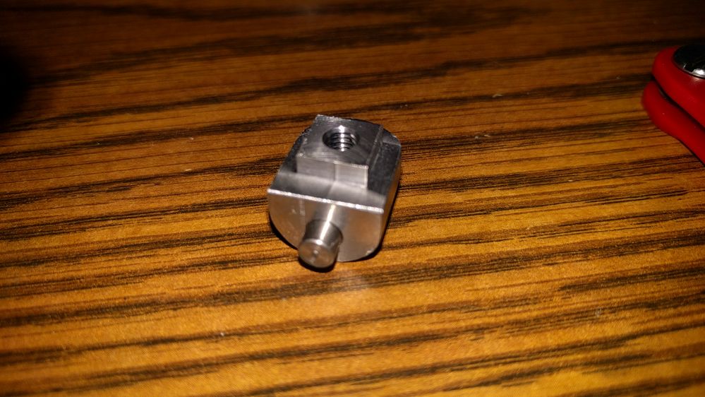

I have another question on the same part as yesterday so I can not share the file.  While doing an 2D adaptive to mill a square I want the path to over lap.  At the start point there is a tiny amount of stock left.  I know I've seen this feature put can't seem to find it.

I would like the the path that cuts a square to over lap.  The tool was a start point and an end point.  Where those two meet there is a little stock left.  If the end point went say 0.050"  past the start point the little area of stock would be gone.

Okay, here's a sample.
Message 10 of 17
alan
Martin,
Now that I have a little time the picture shows the left over stock.
Message 11 of 17
martin.dunschen
Thanks @alan, I'll take a look at it as soon as possible. The picture is very helpful.
