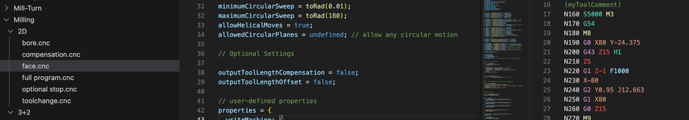

Hi there, if I'm right... according to the Post processor training guide on chapter 4.9 the "optional setting" should disable the G45 output. What am I missing? "N200 G45 Z15 H1" still there.
outputToolLengthCompensation: false
I'm using the latest Generic Autodesk RS-274D post.

Hi @zelfPX3TT ,
you must define these settings within the "settings" object as shown in the screenshot below.

Hi Achim.N, thx for the reply. Still no luck.
Also when I put it in "properties = {}", no luck;
 What am I missing?
AchimN
Ah wait, which of the two RS274D posts are you using?
The "normal" or the "sample multi axis" one?
In case you are using the "normal" one (the first in my screenshot), then the settings you are trying to use will not work as this postprocessor has not yet been updated to support the new settings.
I´ll make a task to get that post updated as well.
Achim.N

Hi Achim,
Great. Thx. I'll start over with the Multi-axis version. Again... thx a lot!
