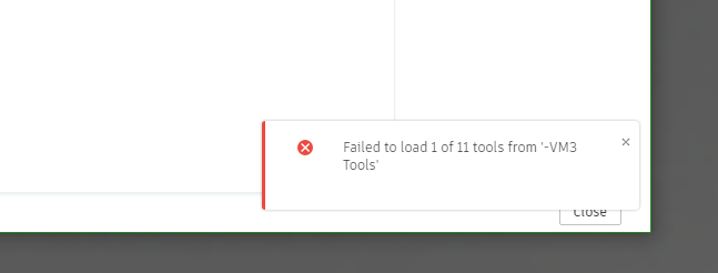

nick_p3dcreations
Is there anywhere I can find a log file to look into why I am getting this error message?
Message 87 of 267
MatthewPBryant
Hi @nick_p3dcreations ,
At the moment, we don't store any logs with more details about why the tool couldn't be loaded. We are working on loading the parts of the tool that are valid and letting the user fill in any missing data. Hopefully, once that work is completed you will be able to see what the problem with this tool is and be able to fix it within the tool library. For now, if you want to get the tool working and are comfortable doing so, feel free to send me the tool library in question in a private message and I can look into fixing it for you.

nick_p3dcreations
I found the culprits. The two tools causing errors were a 1/2" roughing endmill (which shouldn't be anything nonstandard) and a 45deg undercutting tool (that doesn't surprise me since it was a bit of a hack on it's own).
I uploaded the files here in case they happen to be helpful for troubleshooting.

MatthewPBryant
@nick_p3dcreations
Thanks for sharing those tools with us. The roughing end mill seems to be a valid tool and should load in the new tool library, are you sure that tool is not loading correctly?
It looks like you might have exported this data from the new tool library? Because the new tool library couldn't load the undercutting tool it hasn't exported the tool. You can find the original tool data in C:\Users\<username>\AppData\Roaming\Autodesk\CAM360\libraries\Local . From there, you should be able to see a .json named after your tool library. If you share that, I should be able to see the invalid tool and work out what the problem is.
