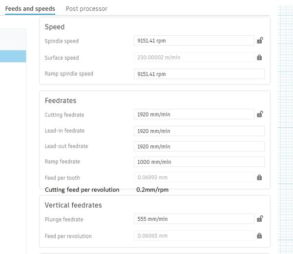

2. Add the value "feed by turns". At the moment this value will only show in the section of vertical feed
- Does this not refer to the "Use feed per revolution" check box in speeds and feeds tab?

1. Not really know what you mean with "multi speed". On the operation passes tap i can set an finish feed. In the tool setting this feed will not shown. So it can be useful to define a finish feed in tool setting.
2. Only a information line or eventually a textbox to see the feed per revolution. Some ma machines (Mazak...) show this value in the screen. So this is what i see every time everyday.
