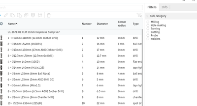

mattdlr89
I think it would be good if there were more "Tool Categories" on the filter option at level 1. For example I want to find a tap in my tool library but I have to click Hole making > tap. Why make something 2 clicks when it could be done in a single click. Only minor but would smooth the workflow nicely...
In addition would be nice if that filter was smart based on the library selected. In the screenshot below Turning, cutting, probe and holders are all empty. I'd rather it see finer level detail of the tool categories that are in that library.
Basically the first filter should probably be "type" and then only the types that are present in the selected library visible.

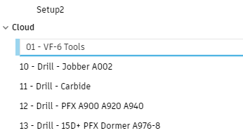

mattdlr89
@christopher.cooperVHK2N
I noticed a small bug yesterday (not sure if this has changed since the update or always been a problem). When renaming the tool libraries you cannot scroll left or right with the arrow key. Present on Windows and Mac.
Also as been brought up before the sorting/order of cloud libraries keeps going awry. Yesterday they were all in order apart from the one at the to being put at the bottom. I changed it so the one I wanted at the bottom should be at the top and it ordered how I wanted. Got back to it this morning and now they're ordering correctly so the one I wanted at the bottom is back at the top. Not a big problem but would be nice to have reliable alphanumerical sorting.
Message 231 of 267
@mattdlr89 Thanks for posting. The issue re Cloud libraries and arrow bug on rename has been addressed and you should see these in the next release.

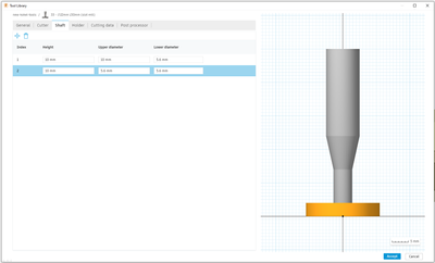

ltomuta
@ltomuta wrote:
Once I define a shoulder length higher than flute length all the shaft customization is done above the shoulder. See below  the two segments I need to be below the shaft, they are modeled above it.
Here shoulder length = 30, flute length = 4
Only if shoulder length = flute length = 4 the segments are modeled in the correct position
Defining a new mill today, I got the same issue as above plus the bonus of a thin disk right above the flutes. A rounding issue somewhere or a new enhancement of the old bug?

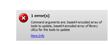

ltomuta
Nice new improvements released today. Theoretically.
When trying to to as much as a tool copy or even tool select I run into
Message 239 of 267
MatthewPBryant
Hi @ltomuta
Thanks for your post and sorry to see you're having issues with the update! I can't reproduce the issue you're seeing here - could you provide a few more details to help us find the issue, please?
  • What version of the tool library are you using? The version number is shown in faint text in the bottom left corner.
  • What are the steps you're following to get this error? In particular, where are you copying tools from and to, how many tools are you copying, and are you copying using right-click copy/paste or by dragging and dropping?
  • Would you be happy to send a copy of the tools/libraries you're copying from/to? You can export them to JSON by right-clicking and selecting 'Export library'.
Matt
Matt Bryant
Sr. Software Engineer
Message 240 of 267
ltomuta
I'm sure if you search a bit around you will find other instances of this problem being reported. This is not a new bug. Usually it goes away after a Fusion restart. This time it took two restarts for the problem to go away.
When this happens, usually there's also the "Unable to select tool" error (which I guess is caused by the same "copy to document library" base-64-encoding error although the tool library does not show it as such).
In this particular case I was just trying to copy one tool from our "all tools" library to the "most used" library, for easier selection. Both library files are old, tried and tested. The tool itself added ages ago and used a lot, so not subject to some error in tool definition possibly caused by recent changes.
Tool library version is 1.15.1. The issued showed up right after the "restart to update" to the most recent Fusion release.
I can send you our tool libraries but I'm afraid it would not help unless we somehow manage to find how to trigger the bug. It only shows-up at random and right now, after the two consecutive restarts, copy/pasting the tools works like a charm.
