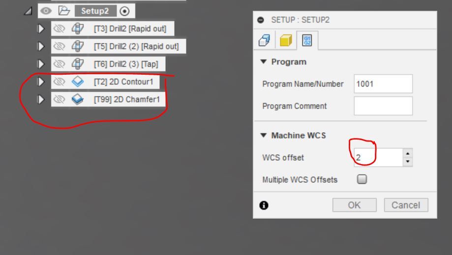

I haven't used Fusion in couple weeks, fired it up today and it updated, then I notice that Post Processor dialogue has switched to the new version that I disabled couple updates ago when it was first introduced and kept happily using the old one, but now it is back...
two questions:
1) is there a way to switch to the old dialogue still? I remember using an option under Preferences, but can't seem to find it any more, I don't want to go into details, but I very much prefer the old one to this new "improved" one
2) since this new post processor dialogue was introduced, I noticed couple extra lines starting to show up in the NC code (I use customized Heidenhain post processor for an older TNC355 control):
4 TOOL DEF 99 L0 R+3
5 TOOL CALL 99 Z S4000
6 L M3
7 CYCL DEF 7.0 DATUM SHIFT
8 CYCL DEF 7.1 #1
9 L X+55.446 Y-3.587 R0 F2000
10 L Z+23 R0 F2000
lines in question are nr. 7 and nr. 8, I can't find any way in the new post processor dialogue to switch these off, this never showed up when I used the old dialogue, so it must be some sort of switch in the new one, but I tried turning on/off anything that might be relevant to no avail
Under Setup the multiple WCS offsets is turned off but the #1 seems to be tied to the WCS offset number used in the Setup dialogue, I tried switching it to "2" and the new posted code had indeed changed to "8 CYCL DEF 7.1 #2"
the odd thing however is that the drilling operations aren't affected, just the contour and chamfer, but it is my understanding that if I don't check the "Multiple WCS offsets" that Datum Shift shouldn't appear in the posted code at all, and it didn't before this update...

Thanks, old dialogue is back, but the Datum Shift problem is still there, I hoped switching to the old dialogue would cure that, but it didn't
Ah, found a solution, opened up the post processor and under WCS settings there is an "if" that puts the Datum Shift in if the WCS value in the Fusion Setup dialogue shown above is >0, so I set it to zero in the Setup window and it solved the problem!
I guess the latest update changed the default value in that Setup window from 0 to 1, I honestly had never payed attention to that, never used that option in the past.

The datum shift will appear if you have the WCS set to anything other than 0.
have you tried setting it to 0, that is what the default value is, shouldn't have anything to do with the post process dialog(NC programs)

jz79
As I tried to explain earlier, I have never touched the WCS setting in the Setup window, and never before this last update had any issues
Just now I fired Fusion up and created a new part, went to Machining and started a new setup and WCS defaults to "1" in that window now, changing it to "0" every time would solve my problem, but I opted to edit the post processor to change " if (currentSection.workOffset > 0)" to " if (currentSection.workOffset > 1)" so I don't need to remember to change that WCS setting to 0 every time.
I'll say it again - never before have I ever used that setting, and it started doing this right after the latest update

mattdlr89
Looks like Autodesk changed the default value, I think that was because 0 would normally default to 1 in most post processors so perhaps 1 made more sense for the majority of users, obviously not in your case.
I know you have fixed your problem through a post edit but you can also set defaults in the setup (or any operation) by right clicking and selecting "save as user default".
