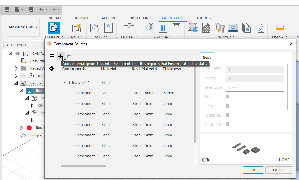

The second case, treating the parts separately, is done via  the Component Sources command, which allows you to combine one or several documents into a single manufacturing environment.
When you add models from other documents in this way, you will see multiple entries in the "Nest Study" dialog when you choose "Multi-value" for "Job Quantity":
This makes it possible to combine completely unrelated assemblies and/or parts into a single manufacturing document to achieve more optimal material usage, since there are more possibilities for the nesting engine to try. This is precisely the reason why the "Nest Study" concept exists, and why we provided the "Component Sources" functionality in the first place.
