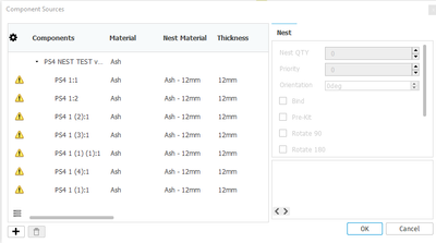

I'm missing something with the new Nesting feature in Fusion.
Following this video.
https://www.youtube.com/watch?v=UH3RhTTp30k&t=642s
I've followed the steps:
1. Make all bodies I want nested into components.
2. Go to Manufacturing tab>Components Sources. (All of my components there have "Warning MULTIPLE PARTS FOUND".)
3. Go to Process Material Library and add packaging
4. Go to Nest study and select my components under shapes, leaving all settings default.
And it displays some very confusing layouts. What am I missing here?

Thanks for letting us know about this, it is indeed a quantity recognition issue,we've created internal ticket TRUNFSN-2251 to investigate this issue, and apologies for the inconvenience.
The attachment PS4.f3d is similar to the attachment PS5.f3d in your other post, so they could be caused by the same problem.

8. Go to Manufacture>Fabrication>Manage>Component Sources
All components says "MULTIPLE PARTS FOUND"
