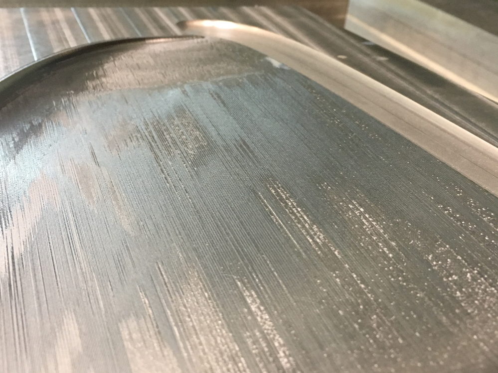

Hi. I'm pretty new to F360 and to cam in general, but I have a job to do 🙂
I've done some die's for a customer, but I keep getting these little 'errors' in the surface. (see pictures)
I've done 14 parts now, and I only have the errors in half of the parts.
It improved a bit when I changed the tolerances to 0,0001mm but it didn't remove all of it.
Anyone have an idea what is causing the errors you see in the pics?
I'm using a HURCO VMX42 3-axis.
Would be great with some help 🙂

You have Smoothing turned on, which can affect the surface quality - depending on the geometry.
My guess is that this what you are seeing, and that you can improve the results and performance by turning Smoothing off, or tightening the tolerance quite a bit on that one.

Tolerance 0,001mm , no smoothing, stepover 0,2mm, parallel finish didn't work.
I tried a scallop instead. same parameters (just as much to verify that it's not the machine)
Some areas look great (apart from the 150´ corners), some look like crap. The toolpaths are not aligned properly?...
Don't know what to do...… Could get a better result with an anglegrinder... 😞

The thing is, the transition between the two surfaces is what it is (I didn't design it 😉 but the errors in the other parts of the 'smooth' areas are really killing me. They feel like being 3-4/100 deep, and they don't appear in the same place, if I do the finishing in different ways.
This is the same part/area done with parallel finish (0,2 step 0,05mm/tooth, 10.000rpm's)
And with Scallop  (0,2 step 0,05mm/tooth, 10.000rpm's).
So depending on which way I run the finish, I can 'move' the bad areas around.
There may be some design-related error between the two surfaces, but the rest should be smooth?...
When I said I had done 14 parts and half was good, that's related to these errors (marked in blue). Some parts are allmost free from errors, others need a lot of polishing.
Right now, I doing finish-run no.6, to get the parts done. I tilted a parallel finish 20 degrees (had to try something) we'll se in 2 hours ;)...
The thing that bugs me (and please remember that I'm very new to 3d and cam) is that I cant seem to get a consistent result from part to part, even though they are very much alike, and I use the same settings, same machine, same stepovers etc...
I've been milling for 20 years and I thought that this was going to be fun, but I'm not sure anymore… 😄
I've done 3d before, but only with function in mind, not finish.
This job has to be done with a finish Ra3,2 or better (in some areas) and when I do 3d directly on the machine, it can finish to Ra1,0. The results I'm getting with F360 (in the bad areas) are closer to Ra6,3.....
When I go through the posted data, I get 3 decimals, which should be more than enough to get a smooth surface.
I just don't understand?...……..

I tried both 0 and 90 degrees finishing with parallel, starting in the middle. Same kind of errors in the surface….
I'm doing a run now, with everything tilted 20 degrees, just to see the difference ( pictures in 20 min)
I tried both 'one way' and 'both ways' milling, and 'one way' does create a better (more shiny) surface, but the errors are the same.
To me, it seems like the F360 miscalculates the toolpaths, as you can actually see them in the simulation.

I took a look at the posted code (using the standard HURCO post), and noticed that there seems to be some correlation between moves around large radius arc moves and your bad finishes.
One way to test this is to have the post convert large arcs to line segments. To do this, just change the "(Built-in) Maximum circular radius" parameter from the default of 1000 to something much smaller. Try 10.
This is a bit of a guess, but I hope it helps.

I tried what you suggested last night, but it doesn't seem to do much better...
It's another part but with the same design-ish. It's one of the 4 wings, so everything is just bigger 😉
I set the max radius to 10 and did a parallel finish with almost the same settings, but I still get those faulty lines.
I also do a 'pencil' along one of the curves, to clean it up, which look almost polished! It's so beautyfull, and if the rest of the part could look like this, I'd be dancing right now 🙂

Thanks for the files. I looked a bit more at the toolpath, and there are a couple of differences between the pencil and the parallel, either of which I suspect could explain the difference seen physically on the machine:
  • The pencil is only removing 0.05 mm of material vs. 0.2 mm for the parallel (since the areas of the pencil toolpath has already been finished once by the parallel).
  • The pencil is machining in one direction only, whereas the parallel is set up for both ways. You did mention that you tried this before, so that's probably not it.
  • The pencil toolpath has much denser point distribution. This should not matter, though, as both toolpaths are inside of the tolerance, and if you compare the following stock simulation screenshots you can see that the toolpath should provide similar finishes:
PencilPencil
ParallelParallel
Parallel - nearer the part centerParallel - nearer the part center
If you disregard the graphics artifact (black lines etc.) and pay attention to the reflections (jagged brown bands), you will notice that the quality is similar between pencil and Parallel. This should be a pretty accurate representation of the kind of finish you would get with a "perfectly rigid" machine, tools that can't bend etc. - in other words ignoring the physical world (which simulation does).
I am sorry that I cannot say something more definitive.
