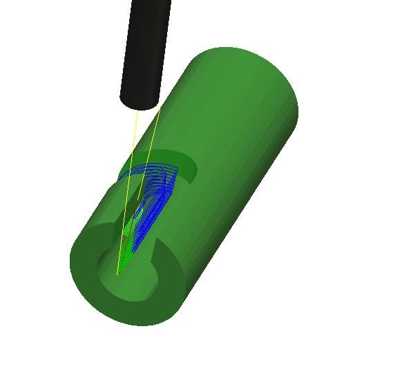

Hi everyone. I'm new to Fusion (Legacy) and have been searching the forums on my slow internet which is taking a long time. I'm trying to get this figured out before I lose any more hair. I have a couple issues. I'm trying to multi axis contour what will be a chamfer on a plug. The simulation does not follow the complete path and the tool top does not appear to be running perpendicular to the path. The part is going to be mounted on the trunnion table with my A axis tilted at 90 deg and the B will do the rotation about the Y axis. The other issue is: is there a post processor for an old Haas with a trunnion  table?

So here's another one for you on that same part. I've been trying to mill that wrapped slot. I've tried a couple way and keep getting either an error or a funky toolpath...any suggestions?

I've been playing with your file a bit, setup is for A axis so I can verify posting. If you reset axis in setup to have rotary on Y axis, just change axis orientation in setup and regenerate tool paths.
May have to reset tool orientation in operations.

Good one Rob, for some reason I thought I only need to wrap radial slot and didn't even try to see if it would work in one shot.
Message 15 of 18
On the other hand, I took closer look and it seems that doing it in one attempt violates model in two places and leaves uncut sections of strait slot.
Compare edges of model with tool path and it looks like splitting sections correctly aligns tool with each wall.
Single contour, OD used as wrap face, tool path not in sink with model edges.
Split sections, ID used as wrap face, tool path matches model edges.
Message 16 of 18
Just to clarify, in wrap tool path tool points to center of model and therefore cannot machine walls of strait slots that don't align with center of model.
Separation of strait and radial slots enables use of tool orientation in machining of strait slots.
Wrap tool path disables tool orientation and if used for entire contour it violates all 4 walls of strait slots while leaving uncut sections on ID edges of walls.
