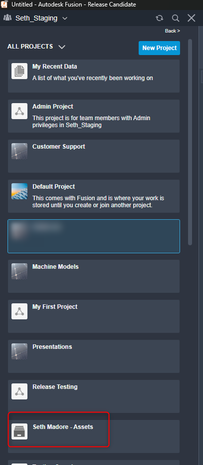

When you migrate from a Single User to Team Hub, all of your Cloud Assets are placed in a new folder near the bottom of your hub in the data panel:
