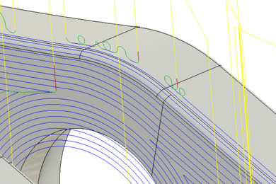

It would be nice if tool paths like scallop had the option to set a minimum pass length somehow. I know this could all be done with trim, but that could potentially be avoided. On parts with more organic shapes I notice what's going on in the image below happens a lot especially when do not touch surfaces are selected.

Machining segments like this can typically be avoided with the right combination of Tolerance and "Additional Offset" applied. I typically will have a .0001" tolerance and a -.0002 "Additional Offset" (geometry tab) and don't see those all too often.

This isn't a file I'm at liberty to share. I've tried many combinations of tolerance and offset. FYI surface clearance does more to change this than either of those. But to get it to a point that I would deem acceptable surface clearance has to be around 0.01", which from an finish standpoint is pretty bad. Offset doesn't really do anything since it's set to tool outside boundary. I suspect that tool orientation is more of a contributing factor than anything else, but that's fixed because of clearance. Changing the tolerance can decrease the occurrence of those passes in that one particular location, but actually created more in another spot. I would guess that if the tolerance could actually be zero it would do it, but small tolerances make for a large program size, which isn't necessarily desirable. For some reason turning contact point boundary on and off has an impact on this even though the portions of the tool path that are problematic aren't near one of those boundaries. It's significantly better with contact point boundary on, but still has random extremely short passes. So at the end of the day having a feature where you could automatically get rid of any passes less than a set length would be extremely useful. Not just for scallops too.

When I get a chance I'll model up something that replicates this. I'm not really looking for a solution to this so much as requesting a feature. Currently the only thing that solves it is contact boundary on, surface clearance for avoid touch surfaces set to default of 0.0002" or larger, and then using the trim tool to get rid of the handful of passes that don't make sense.

I find making the top height just slightly below the actual top of the feature elimates these, or switch to something like Ramp
You also get these curlicue/pigtails when doing adaptive inside of a perfectly round bore.

The simplest way to do it would be updating the trim tool to allow automatically selecting all paths less than a certain length. That would save a ton of wasted clicking. A workflow that produces desirable results but takes a long time is inherently undesirable when time is money. The trim tool is especially inefficient because if  I update the machining all those manually selected passes are different and have to be redone. That's better than watching a machine waste time and shake itself apart trying to do a bunch of tiny passes, but that doesn't mean it's good.

I believe you can Trim using a sketch as well, which would stay the same. You can do a projection of the part OD then apply an offset of 1/2 your tool Dia or whatever works.

There's other parts of the operation where the tool center is about 3mm outside of the edge of the part to wrap around fillets. What you're describing is similar to using the boundary option in the trim feature. It would work if the part wasn't a weird organic shape. But projections end up looping around behind portions of the part that should be machined.
